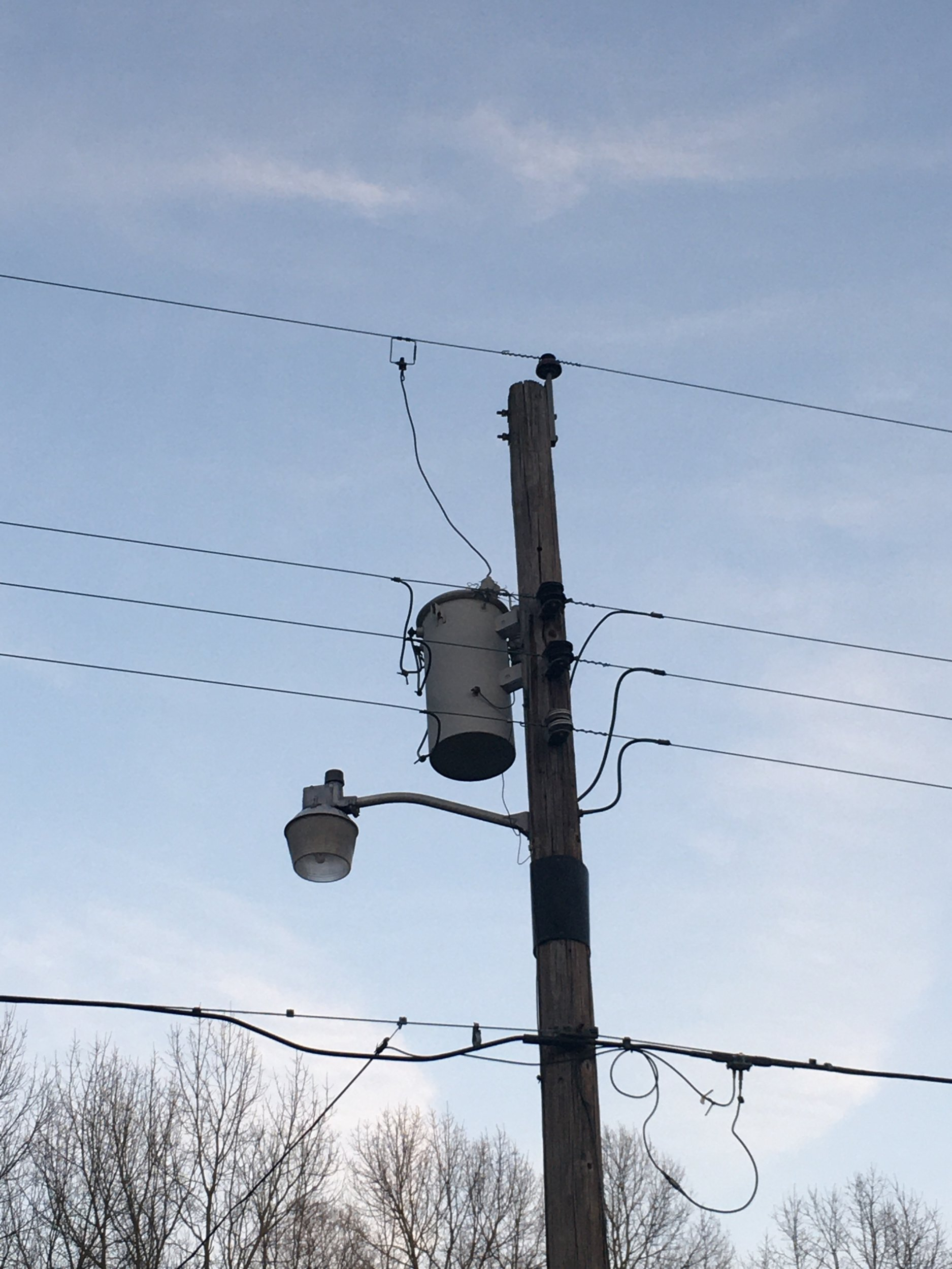

Here's a picture I took about half an hour ago of a transformer a block over from us. It's on a single leg. Do you see a neutral for the high voltage? No. There's only one wire feeding the transformer. The top wire. The three wires below it are the two 120v hots and 1 neutral from the transformer and run up and down the street to 6 houses on each side. The only other wire on that transformer runs down the pole to ground. No neutral for the high voltage side.
Moss,there is a high side neutral wire.They are using the middle(wire) secondary leg neutral ..
