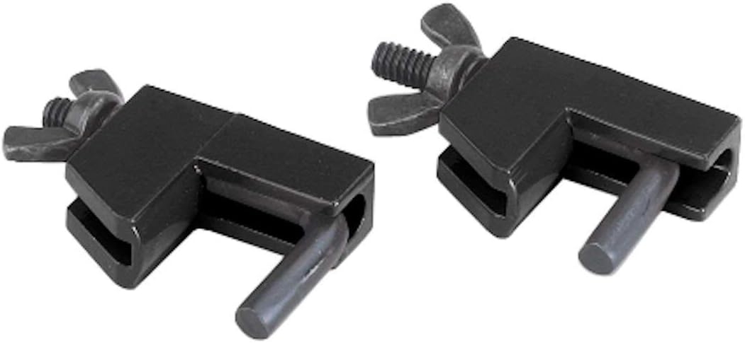

Closest I can come is a BX24. No deck to remove but did have a Bro-Tek crunch plate in the way. Once stuff is out of the way it's no big deal, but I'd suggest you have something like this handy. Otherwise it takes 3 hands and a lot of shop towels...

OK, I give up ... what do these things do?
   / Power Loss in BX2200 #18
Those clamps are used to pinch the hose off without damaging it from sharp edges like pliers or vice grips can.
#19
Oh, OK. Understand. I have been using small vise grips for that purpose and just being careful not to crush the tubing.
