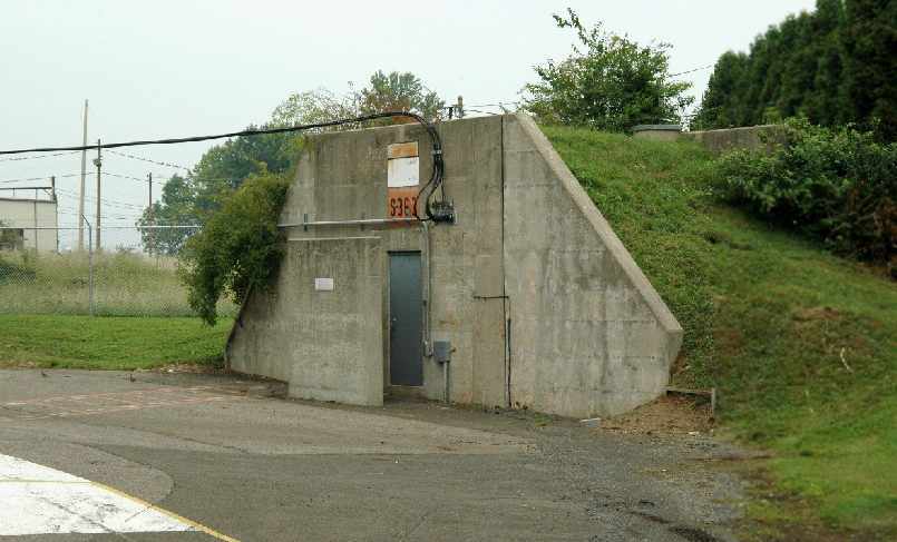

The tops of old military ammo bunkers used to be trimmed by sheep
