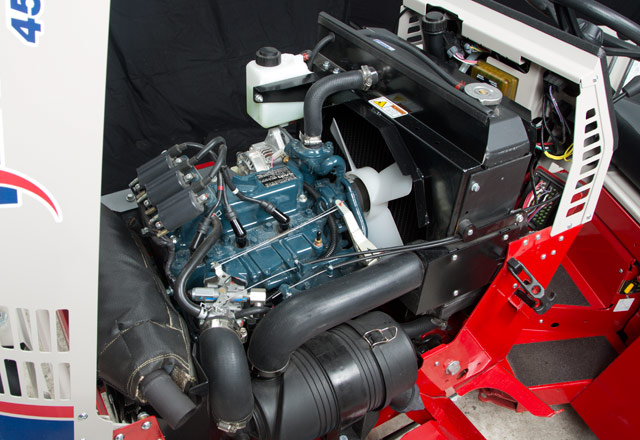

So I have a Ventrac 4231 Turbo Diesel. I am aware that this motor is not held in high regard with the general public. I have almost 200 hours on it so far, with no problems yet. I have two basic complaints though.
1. It overheats too easily. When the temperature is over 80 degF, radiator needs to be kept very clean to prevent overheating. On a 4 hour mow job I will have to clean out the radiator several times. On a really dry day, I will have to blow the dust out of the radiator at least once.
2. Not enough power. On 20+ degree slopes, I cannot go full speed in Low Range when mowing. In my opinion, the motor should be powerful enough to go full speed in low range up to 30 degree inclines.
Other than that, the motor has been great. Runs smooth, and has fantastic fuel economy.
So anyway, the new 4500 motor lineup from Ventrac offers little benefit to what I have, with maybe the exception of the 32.5 HP Kubota. It seemed to have more power in the comparison video. I looked at the Steiner website, and the 440 now has an available 40HP Gas air cooled motor made by Kohler. Just wondering if anybody has tried this machine, and how much hill climbing power does it have? Also, would love to hear all of your thoughts on the engine lineups and which one is best on both brands.
If anybody has any first hand horror stories with the Briggs Turbo Diesel, I would like to hear those as well.

I believe that the 40hp Kohler air cooled engine is a little overrated... It's more like a 33-35hp engine, just like the vanguard 35 v twin... And generac 992 cc 33hp v twin. More importantly then HP rating, look at the torque curve from 2400 to 3600.. I would want an engine that could make it least 50-55 ft lbs of torque thru that whole operating range. As for your 31 turbo diesel over heating., they do run too hot and it's part of the reason those engines just do not last. The non turbo diesel does not overheat...There is very little power difference between the turbo and non turbo models, once again turbo drops a few rpm's its done...

I think all water cooled Ventracs will overheat when mowing, because the screen on the radiator gets clogged up. I owned a Briggs 31HP gas model before the diesel, and it would overheat too, just not as easily.
The only 4500 Ventrac that makes 50 ft-lbs is the Kubota.
   / Power options - Ventrac and Steiner #13
Well the radiator location on the Kubota powered Ventracs might take longer to clog...
   / Power options - Ventrac and Steiner #14
I cannot overheat my 4231g Ventrac even in foot tall grass and mid 90's temps, I do have the new aluminum radiator though. I can't get it over 195 even without cleaning the screen.
