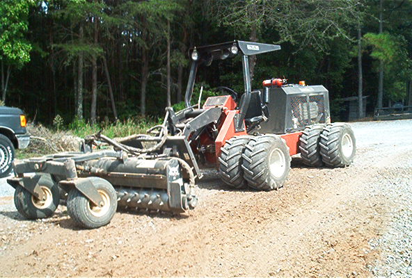

I used a Bobcat brand, after we made the adaptors. Worked great..but had to stay on the hydraulics to control it.

Great Picture AltavistaLawn! /forums/images/graemlins/cool.gif Thanks. /forums/images/graemlins/smile.gif
Just further confirms my need for front wheels though. /forums/images/graemlins/frown.gif
And the list of projects to properly configure the machine to tackle the list of projects grows! /forums/images/graemlins/grin.gif
