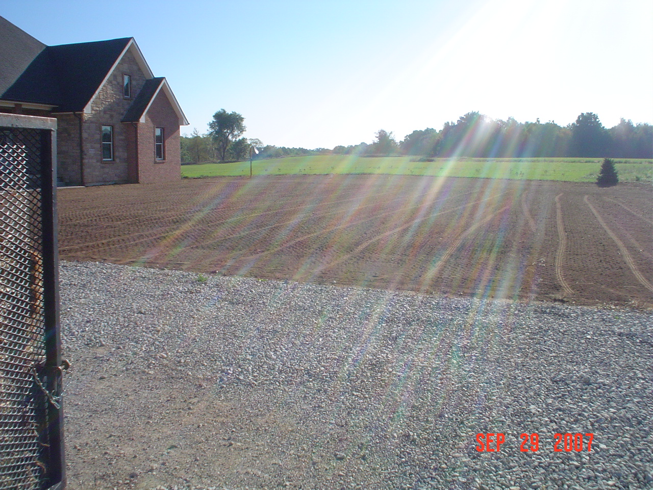

I used to install lawns on the side. Used every type of equipment. If you can rent a power rake this is the way to go...here is a pic of a completed job.
