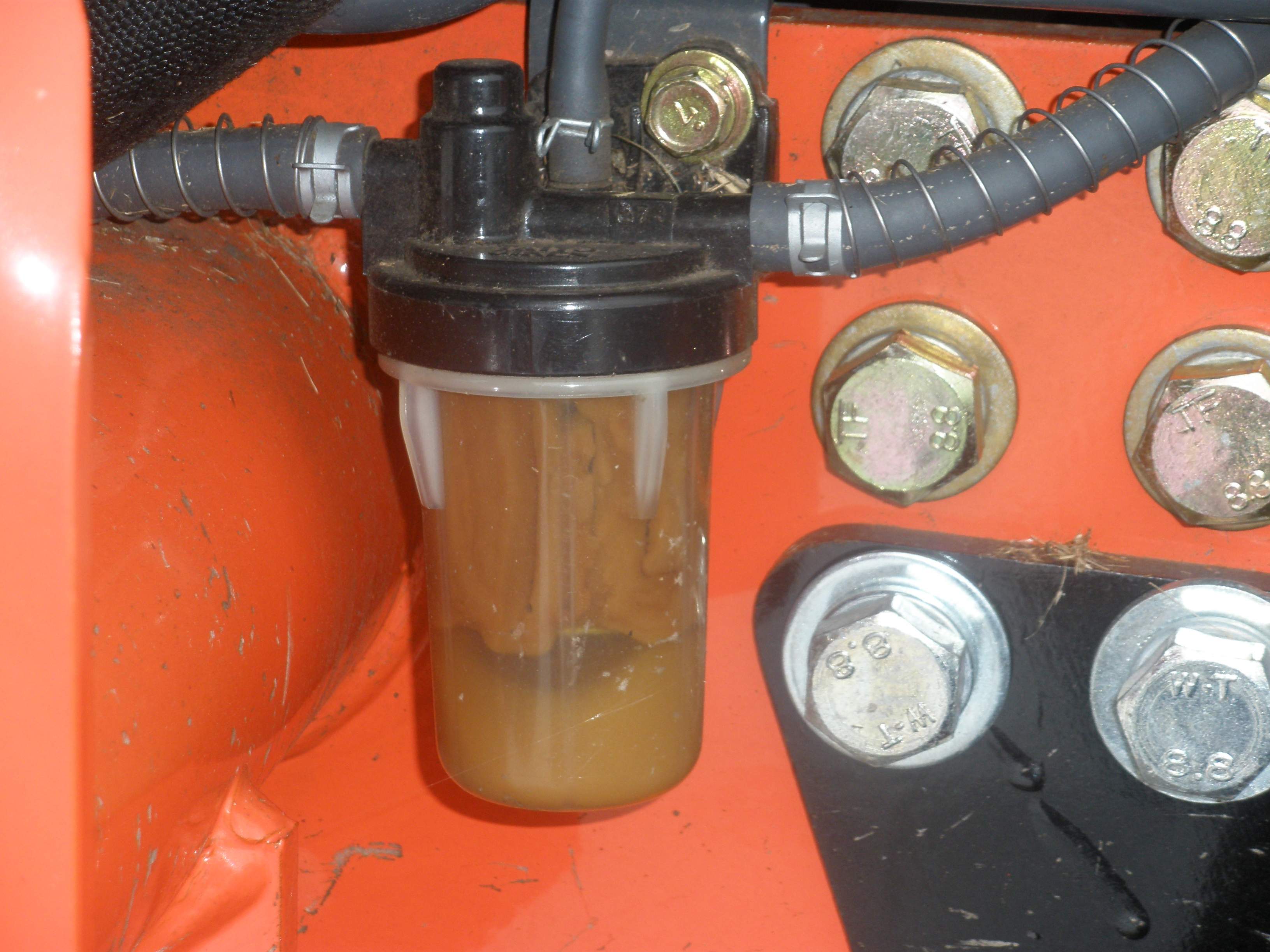

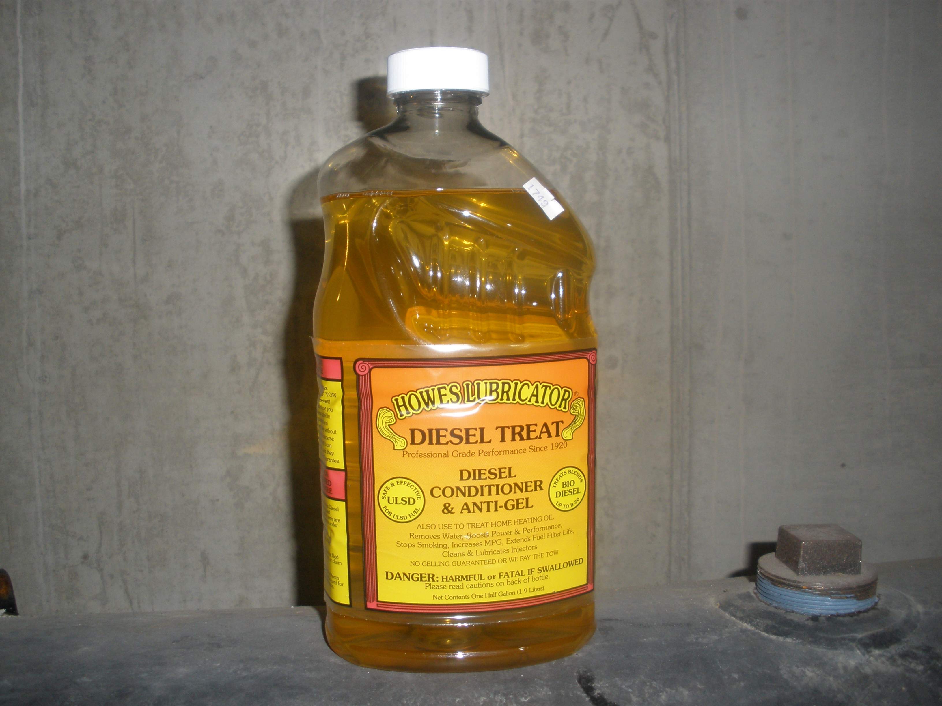

Yesterday I used Howes to get my B3030 working right. I took the tractor from the barn and after 2 minutes the engine sputtered and stalled. I started it and the same thing occured. Looking at my fuel sediment bowl it appears the diesel fuel was gelling. Temperatures have been 10 to 30 F and last time I filled the tank was in October. Yesterday the temp was about 32 F.
I could not find any powerco at my local hardware store but found the Howes at a small EXXON minimart gas station. I paid $18.00 for it. I only needed a few ounces so I initially was reluctant to buy it ( only 1 size bottle for sale).
I added 5 ounces and after 1 minute of sputtering the engine started to work normally as good as new. No problem running the tractor after that. I am now a fan of Howes.
Here is a picture of my fuel sediment bowl before HOWES. Does it appear to have gelled fuel or water in it? Is the filter supposed to look gelatinous like this? When taking off the fuel sediment bowl what is the procedure and should I change the filter? The bowl did seem better after running the tractor.

Nik, no reason to change the filter in the sediment bowl unless you experience more problems. The Howe's should straighten out the gelling problem and you will be good to go.
Sincerely, Dirt
