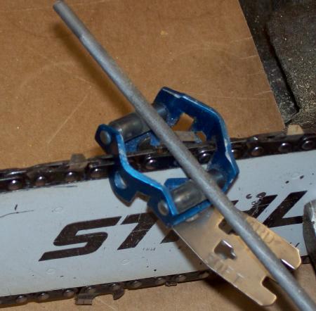

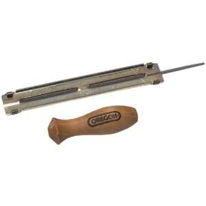

I second the suggestion that it is well worth your time to learn hand sharpening. However, true freehand sharpening (just a round file with a handle on it, no guides or filing jigs) is tough to learn to do well. I've met a whole lot of people who think they are good at it, but only a few who really are good at it.
Fortunately, there is no real need to learn to do it completely freehand. They are some very effective filing guides that help you do it right. Someone already mentioned the Stihl 2 in 1 system (which is basically just a relabeled Pferd Chainsharp system). I find it a bit cumbersome to carry with me, but it does get good results.
Two guides that I have used:
An Oregon file holder that keeps your file at the correct depth when sharpening.
Roller file guide sold by Husqvarna and others:
Both are easy to learn to use, and get great results.
