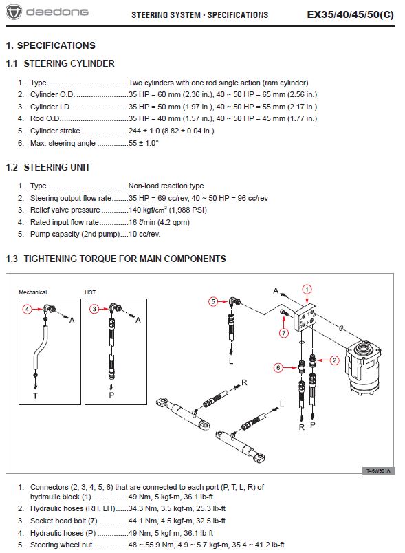

Dadannyboy, I can offer up this page. This is the same system the newer dk35, 40, 45, 50se tractors use. I would imagine its very similar to what you have in the older dk tracor. This should definitely get you in the ballpark on flow rates and pressures.
/ Power Steering control unit -DK 35 #15
PTSG, i have tried to source a good local hydraulic shop, most of the local shops get really poor ratings especially for a non-business customer. I am an engineer by training and am willing to pull the pump apart as it looks pretty straight forward from what i have seen on youtube. Any idea where i could source the seals. thanks
How did you go with this, I have a 2003 service manual/parts manual in pdf for it if you want it, I source seals from the internet, ebay etc, or online hydraulic shops
Unfortunately the parts list file doesn't go into a breakdown of the guts of the steering controller, so it appears Kioti don't sell the individual seals etc.
Steering flow is 4.7 gpm from the specs
