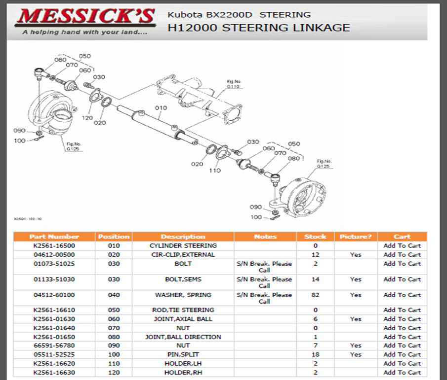

kubota bx 2200
hello,i have a bx2200,about 400 hrs.over the last couple of weeks,it seems that i dont have ANY power steering.i can turn the steering wheel around left or right several times before the front tires react.iv looked foe a power steering pump to no avail,all fluids are good---whats going on??

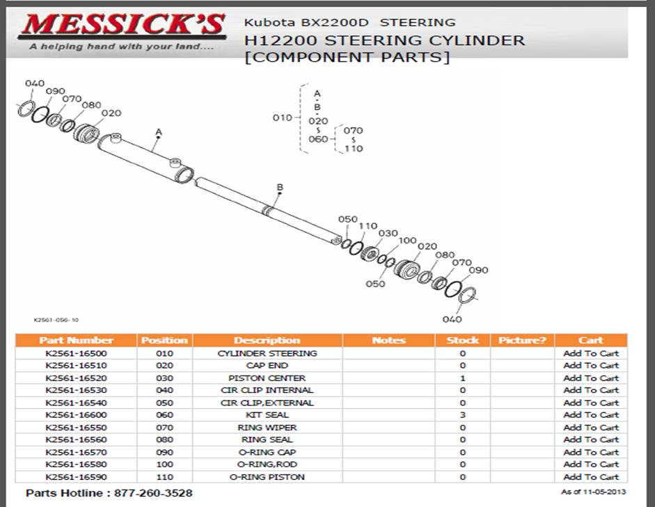

Steering power comes from the same hydraulic pump that runs your implements. Usually the culprit is the seals on the steering ram (up front between the wheels). Search around here, some people replace the O-rings themselves.

I am in the process of repairing my L5030 which has the same symptoms. I could get the tractor to turn by continuously spinning the steering wheel. After doing some testing that was suggested on a thread I posted here in the Kubota forum, I determined that the problem was a bad center seal in the steering cylinder. That proved to be the case when I pulled the cylinder and opened it up. I ordered a seal kit and hope to have it all back together in a day or 2. Good luck with your steering problem.

ok..where is the steering cylinder on a bx2200.....what am i lookin for,down on the axle?...THANKS

No, you are right Ben, the BX series uses hydraulic cylinders for steering and other people with similar symptoms have reported the cylinder as the culprit. I think there was even a service bulletin on the earlier BX machines addressing a seal issue.
If your BX2200 is like the newer versions, and I think it is, it is located just in front of the front axle, bu underneath the front hitch (so it's protected for the most part).
   / power steering gone #9
Perhaps these will help...
