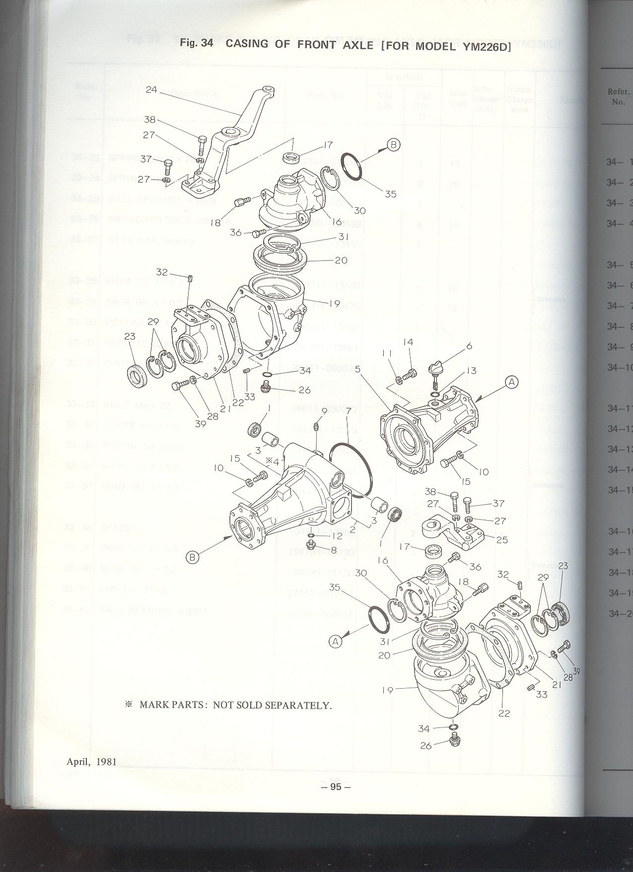

I'm still bothered that there wasn't water in the oil you drained. Did you get to all three drain points on the Yanmar front axle? I would have expected the water to migrate to the lowest places where it could ice up & affect the steering. In addition to the drain on the center portion of the front axle, there are also drains outboard at the two lowest places - one way out on each end of the pivoting portion of the front axle housing. The front wheels bolt up close to these pivoting housings and that makes the drain points there hard to see. But that is where I'd expect the water to be.
I don't have a sectional view for your tractor's front axle, but here is one for the YM226d. It should be the same principle. In this drawing the center drain plug is part 8 and the outer drain plugs are part 26.
rScotty

Got all 3 drainage plugs removed and drained. Didn't notice any sign of an oil water mix tho.
