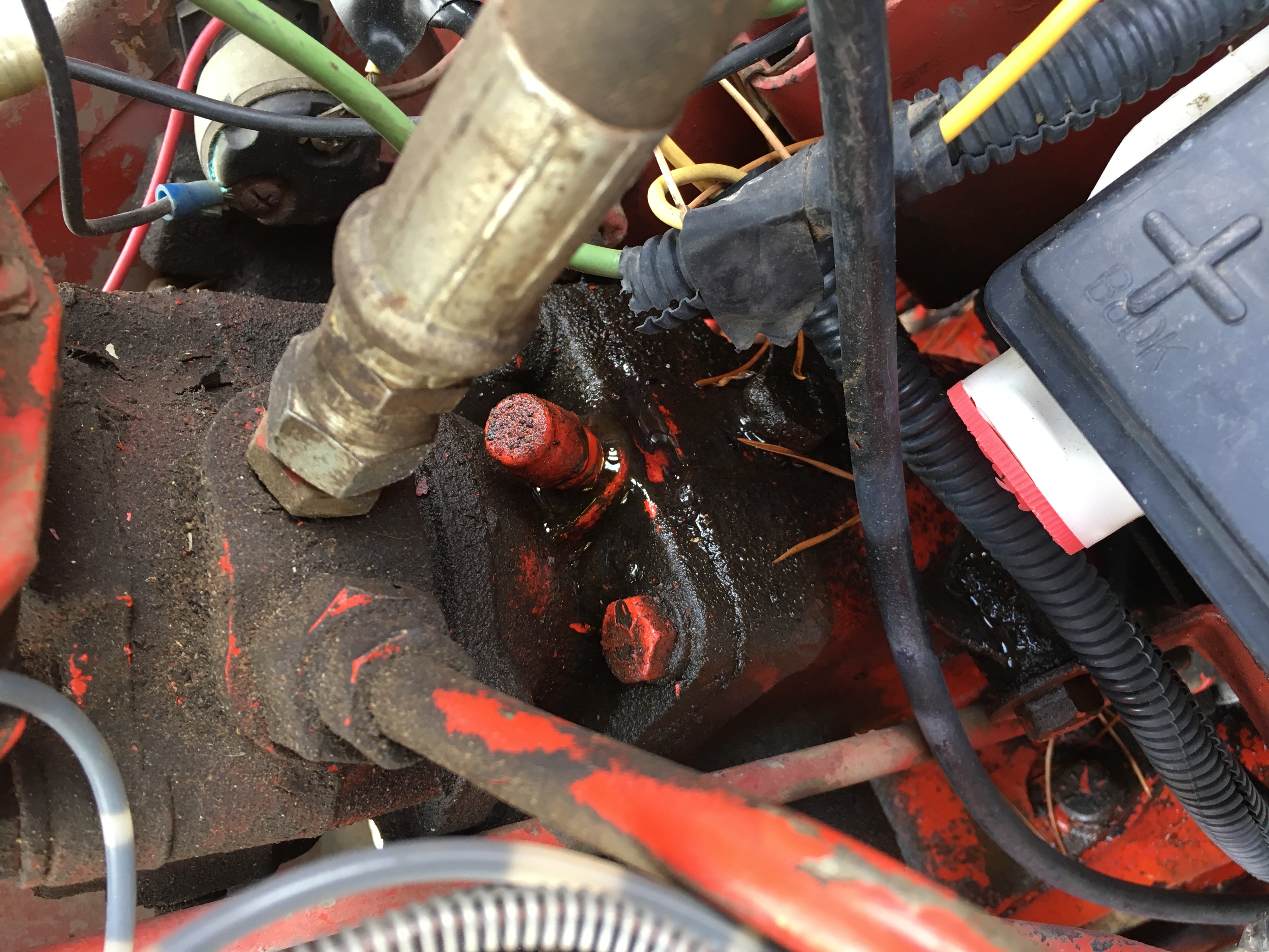

Resucitating this old thread since it seems I might be having the same, or similar issue with mine. 1954 Ford 600. Just replaced the power steering pump (old one had rusted out internally and seized, and I had disconnected the rams for a year or two to drive it manually -- really fun with a load of dirt or snow in the loader....). Anyway, with the new pump on the there, and fluid flushed and refilled, it now leaks out of what looks like a breather on the steering valve assembly, in the attached photo you can see the fluid oozing down.IMG_1074.JPG It leaks out of here a little if you turn the wheel to either side with the engine off too, not just with it running. Also, the power steering pump rattles when you are not touching the steering wheel, with the engine running, but not if you are turning the wheel. It seems to operate the rams just fine. Ideas? Thanks! Zeke

the steering column has seals....
   / Power steering leak #20
That is the breather for the lower box.
Your lower seal in the column is leaking - there is one above and one below the hydraulic block. You will need to pull the tin and steering wheel then disassemble the column to get at it.
Column is not complicated and two seals plus a couple of orings not expensive.
