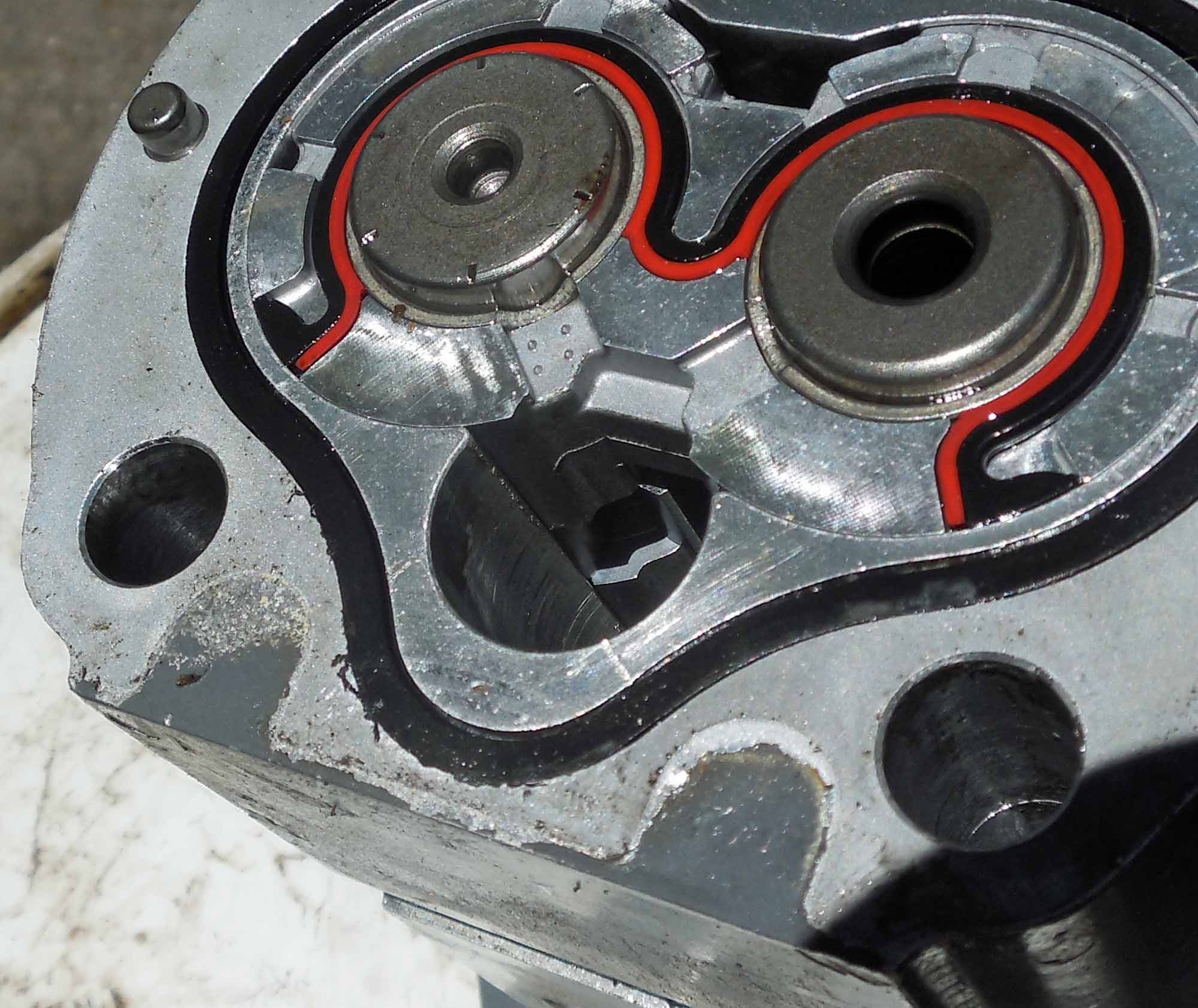

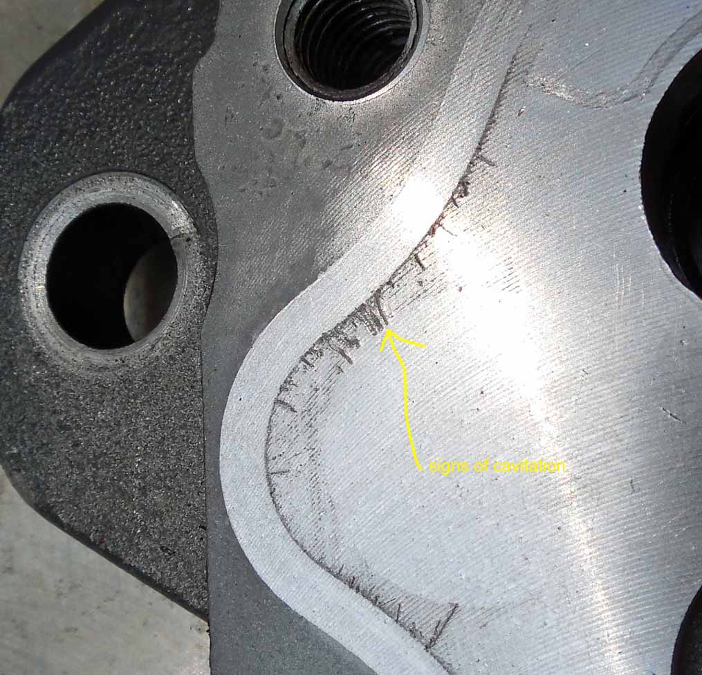

Wow, 20 min on relief. I wonder how hot the fluid got at its hottest.
One of the 2 CK30s I bought new back in 2005 suffered failed implement pumps twice. I did the post-mortem
on the first pump and it had a failed seal plus a lot of signs of cavitation. My conclusion was that the
fluid probably suffered overheating, but I never found out the cause. The tractor is owned by a friend who
is very hard on the tractor. He does not have the detented factory AUX valve.
Anyway, Kioti changed from the OEM pump (Casappa) to another brand (Joyang), then again to some other
brand. Maybe back to Casappa? Sadly, they only supply seals for the original, it seems.
So, I rebuilt the Casappa and it seems to be working now, despite all the cavitation marks. Good thing I
had saved it after the first failure from 6-7 y ago.
