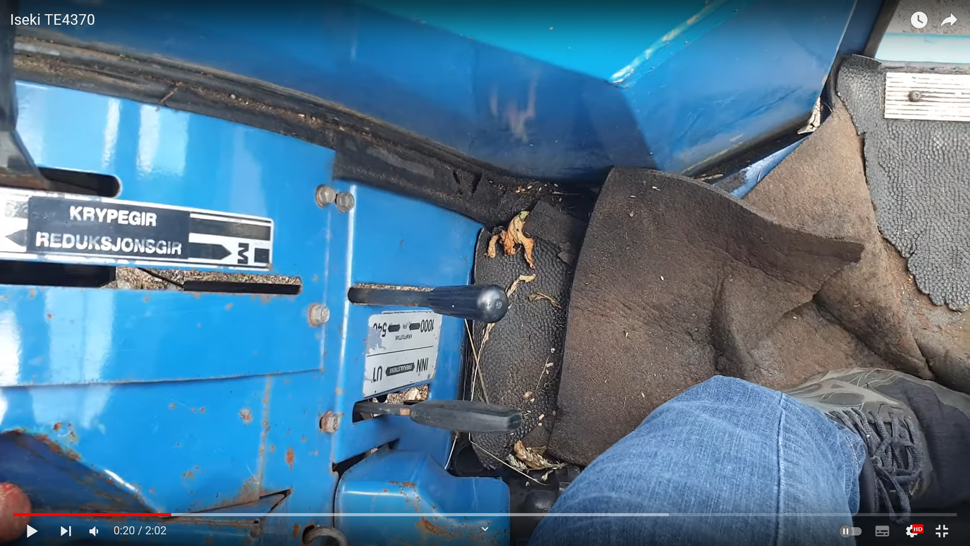

I'm new to operating a tractor and can't get the PTO to operate the slasher. The operation manual does not explain the PTO operating procedure. Any suggestions?
   / Power Take Off operation #2
There should be a lever for the PTO. This is where you select between 540, Neutral, and maybe another one or two more PTO speeds. Let's stay in 540 for now.
You'll need to press the clutch, select the PTO gear and release the clutch. This should get the PTO working.
If you still can't get it to work, try upload some pictures of the controls on your tractor, so we can help you. I tried to look online but there is very little info about that model.
   / Power Take Off operation #3
Ok, found some video showing the controls.
The PTO gear selection lever is right by your left heel. Up is 540, middle is Neutral and bottom is 1000.
Then, there is a small lever by the steering wheel, on the left. This is what I believe turns the PTO ON or OFF. You put the PTO in 540 and then move this lever and see if it turns on.
