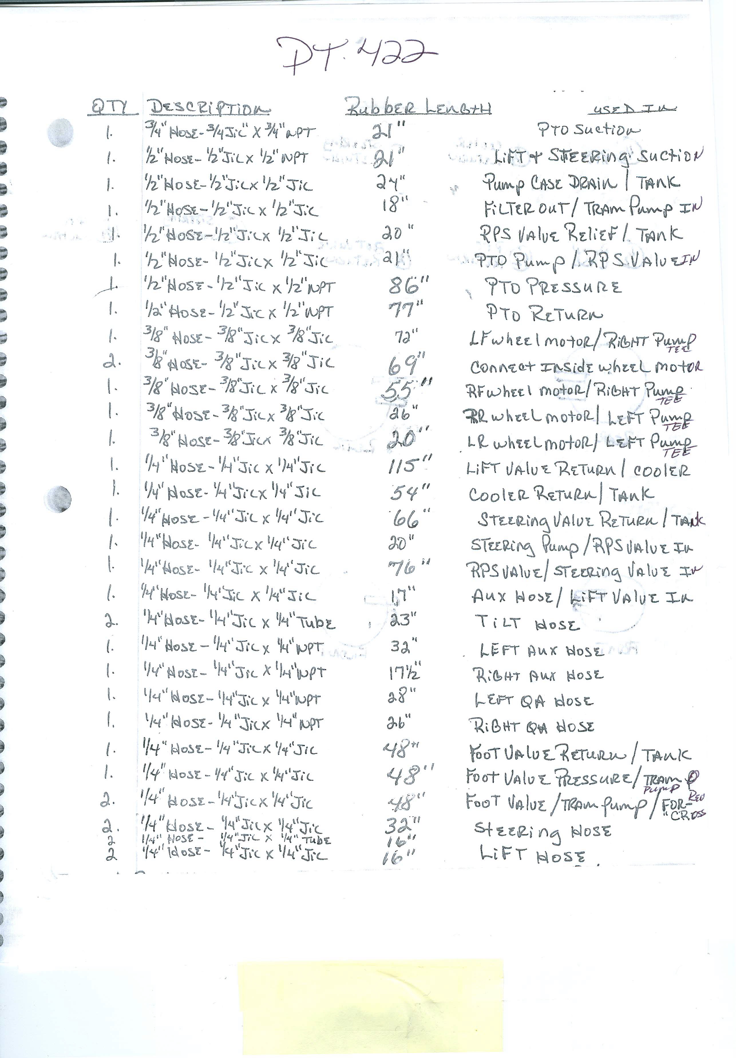

2004 PT422
Hydraulic hose list. Includes length where used and end types. curtesy of Terry from Power Trac
   / Power Trac Parts Cross Reference Thread
#47
WOW! The holy grail of hose lists! :thumbsup:
