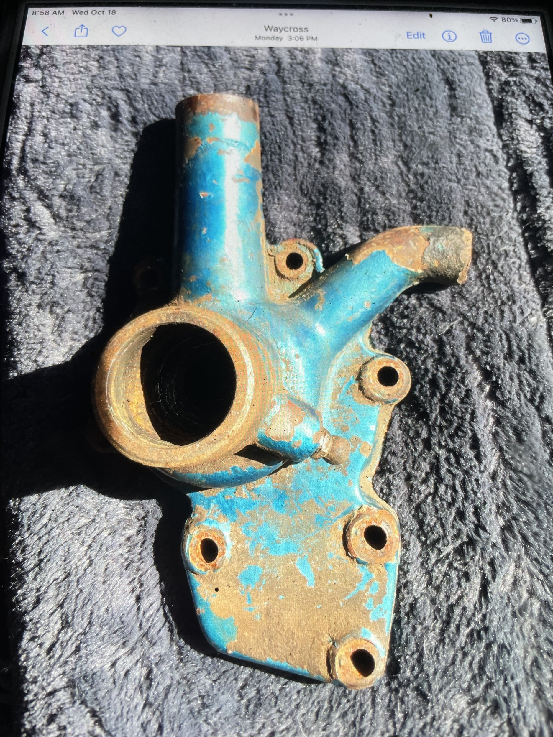

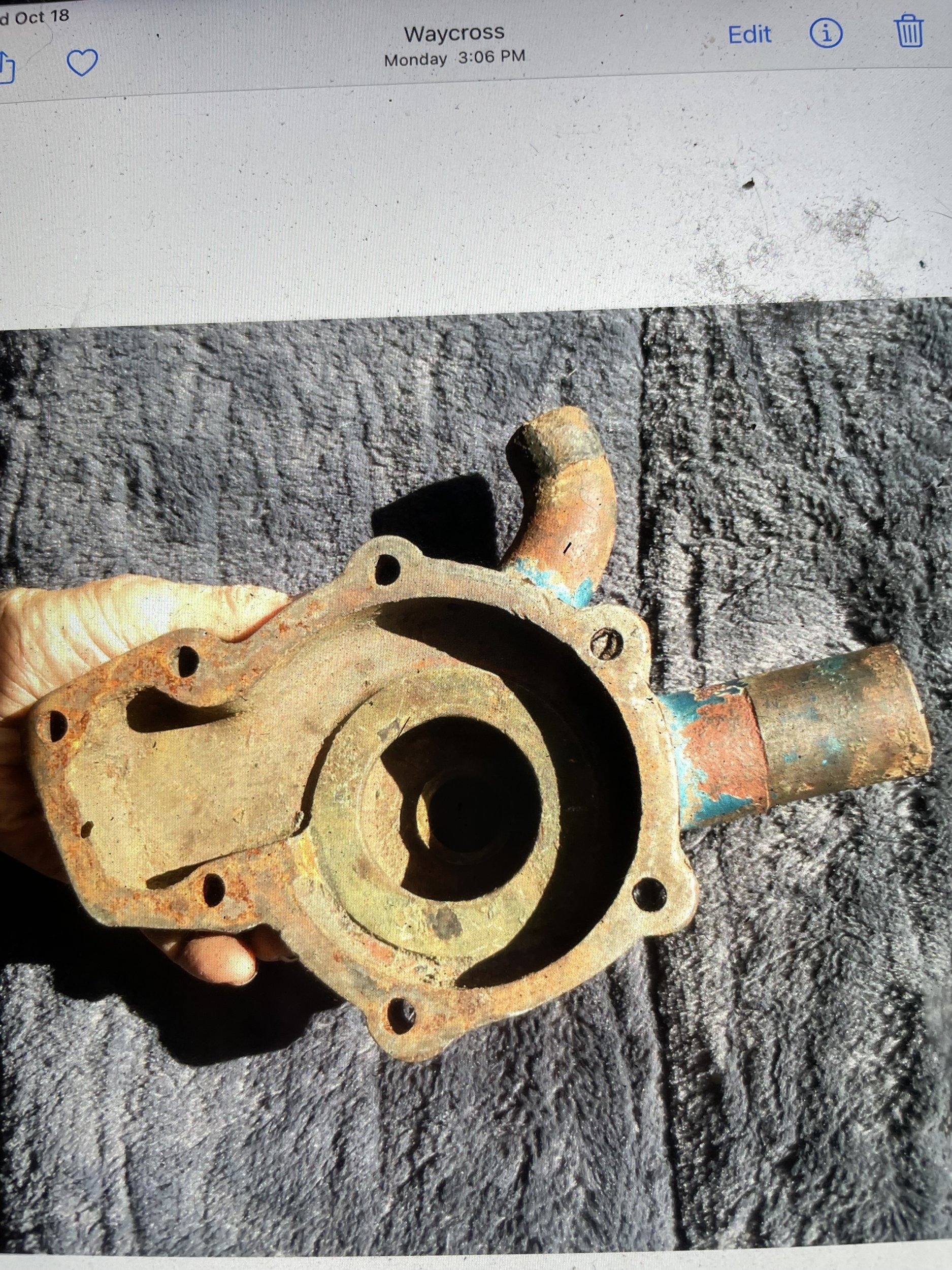

Looks like this. Can it be rebuilt? My husband said bearings needed replaced.
/ Power track PT400 #23
Yes it could be rebuilt, depending on the condition of the shaft and impeller. If it has a carbon-ceramic (mechanical) seal, that may still be in good enough condition to not warrant replacement. Bearings are readily available through any good bearing supplier. Bearings are just bearings, tractor companies don't make bearings.
/ Power track PT400 #24
Already located bearings and shaft is good. Only need rubber seal

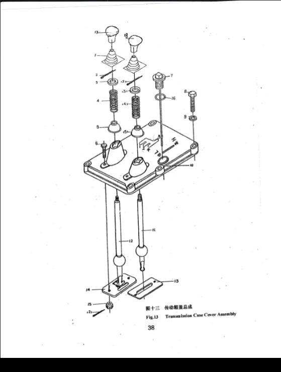

Forgot to mention that item #7 is the dipstick, and that the transmission and bevel gear case share a common sump. If I remember correctly it takes around five gallons of 85W-90 GEAR OIL, not tractor fluid or hydraulic oil.
