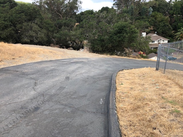

I almost got stuck yesterday trying to pull my unladen 12' car hauler trailer (1460 lbs) up a paved driveway with my PT425.
The drive is between 18-20 deg slope - so it's fairly steep. Trailer is hooked to the PT with a ball hitch on the quick connect plate. I intended to go down hill, then make a left turn off the paved drive and continue pushing the trailer up a gravel road I'd just carved out.
I debated on whether to have the PT going forward on the uphill side (pushing) or downhill (pulling) side. Not knowing the machine (or my) capabilities, I didn't really want to be on the down hill side of the trailer in case things got ugly. Plus, once I got down to the gravel turn off, I'd then be stopping and pushing back uphill, which I thought might provide better weight transfer to the machine and tires.
Down, no problem. Left turn onto gravel road OK. Now pushing the trailer (cocked at an angle) up the gravel road not so much. I stopped and reversed back up the paved drive and almost couldn't pull the hill - the black marks on on drive in my pic are evidence of the rubber lost off the rear tires as I pulled the trailer back uphill (fronts were fine but didn't appear to even be turning as the backs spun.)
So I read posts on here all the time about pulling big logs out of the woods with a chain. Granted I had a steep hill to deal with but I'm wondering if I'm missing a technique here or did I just discover the limits of the machine?

Probably too much tongue weight, so your real tires didn't have enough traction. I have had no problems pushing or pulling a 12' landscape trailer up a gravel driveway that is steeper than that, but the trailer is balanced so it probably has <40# tongue weight.
/ Power/Traction PT425 #3
Try putting a hundred pounds of weight on the rear of the trailer to lighten the tongue and see if that helps.
I frequently bring home my 18' car hauler loaded with a lot of heavy locust wood. I toss the wood to the front of the trailer to give me some tongue weight on the Suburban. However, when I get home, and I want to move the trailer to the back yard with the PT425, I can lift the ball, but cannot push it. So I toss a lot of the wood from the front of the trailer to the rear of the trailer. It lightens the tongue weight and the PT can then push it.
Don't know how that will work on your hill, though. But it's worth a try. That hill looks pretty darn steep!
Thanks guys - I put 250 lbs at the back of the trailer and tried it the other way. Me backing down with the trailer uphill from me. No skidding and was able to push the trailer back up the paved hill. Seemed to help.
Even with that, I felt close to maxed out so I'll leave the gravel approach for another day.....chickened out in other words.
