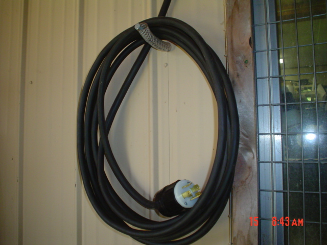

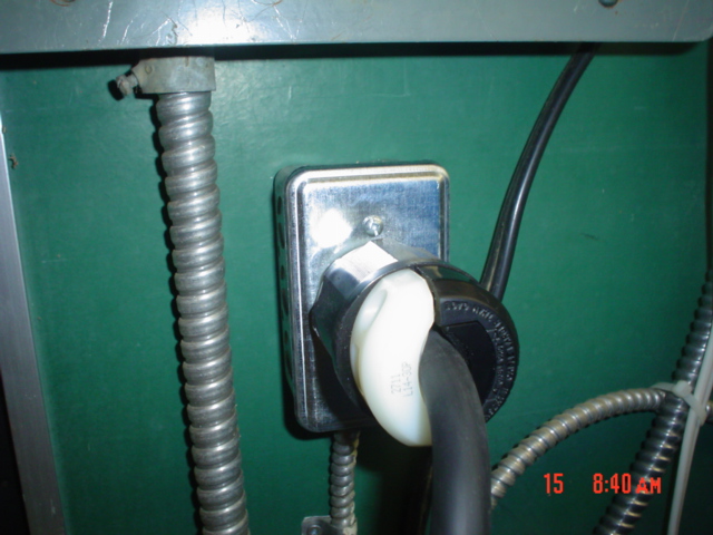

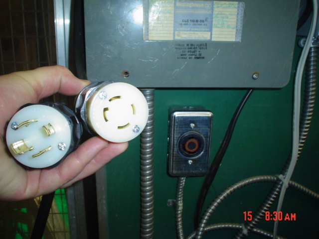

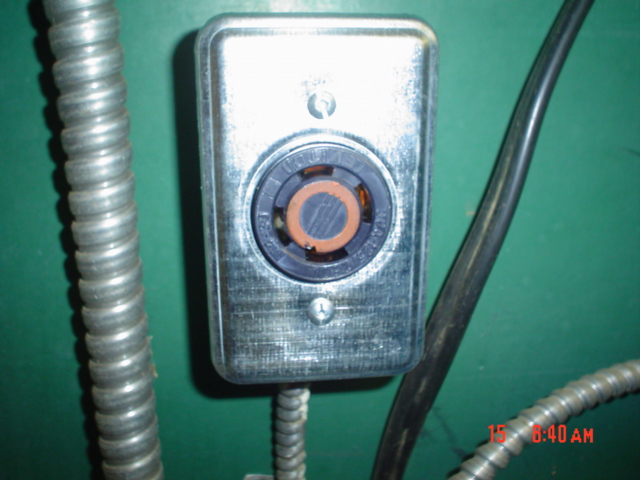

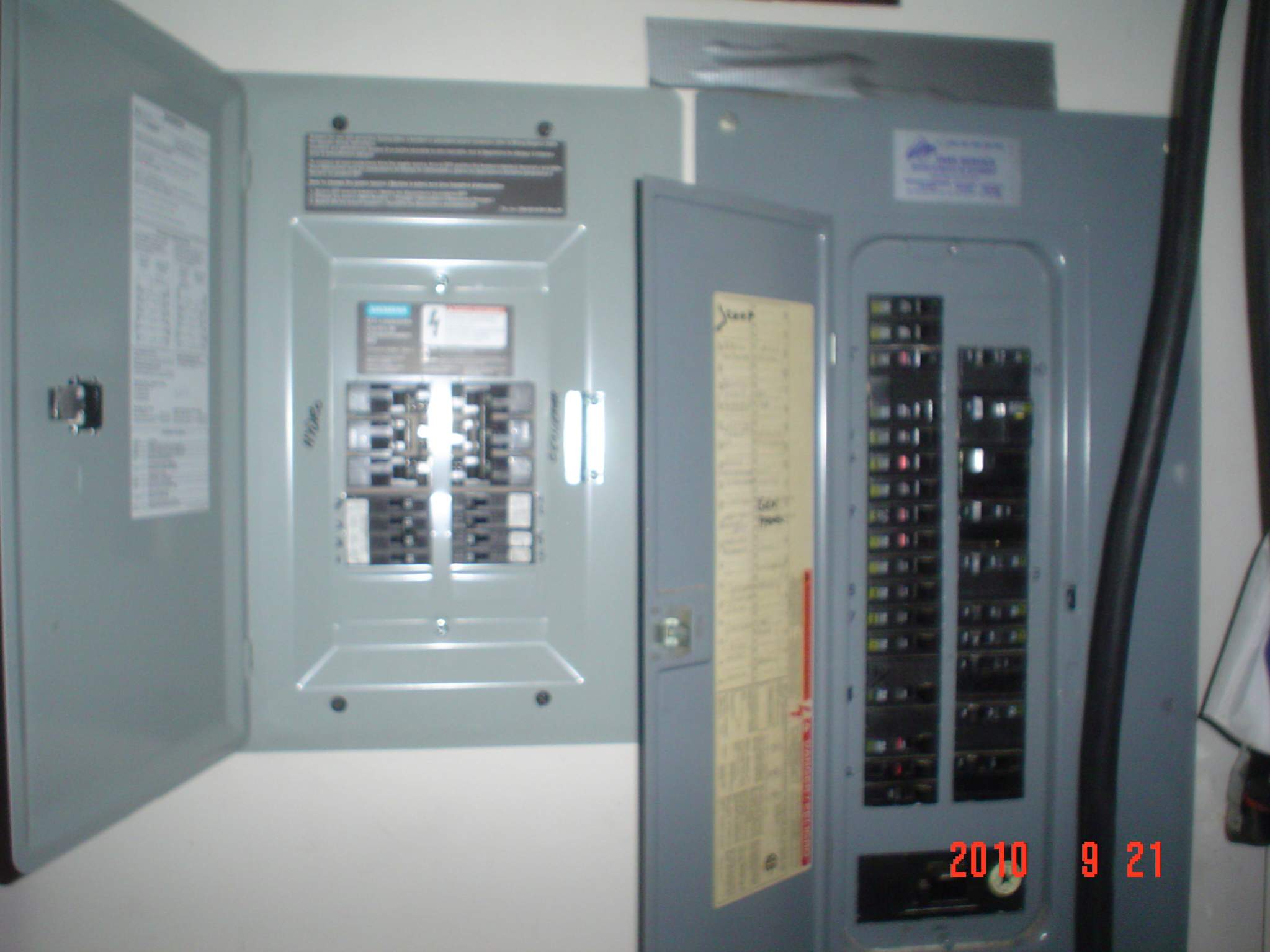

We have a generator panel that will power 8 of the house circuits. It is setup so if we are using the generator panel it will not back feed to the hydro panel, this is for safety. The plug and cord at the shop was wired by an electrician so we could plug in a generator to power the submersible pump that is in our 2,000 gallon storage tank, again set up so only one can be plugged in at one time, either the hydro or generator plug. First pic is of the side by side house/generator panels that are in the house garage, the others are in the shop.
