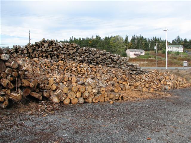

My employee and I split and throw on the truck a cord (128 cu feet) in a hour going at a steady pace. This breaks down to something like this. Splitter cycle time 10 seconds? = 12 pieces per minute = 720 pieces per hour. We have for years piled wood on the truck and have counted how many pieces to a cord. With the size of wood we split it averages 7-800 pieces per cord. Now we know what a cord is thrown on without piling. I have seen it take over 2 hours for one man to split and throw in a pile. It all depends on the type of wood and size.
