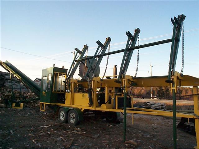

check out these splitters.
Chomper
80 hp diesel, hydraulic winch. 4 cords and hour?!
   / Powered Wood Splitter Productivity? #22
Now that is a wood splitter.
   / Powered Wood Splitter Productivity? #23
Been there done that. What a disaster that turned out to be in the end. $250,000 worth of gear and, well I won't hijack the thread.
