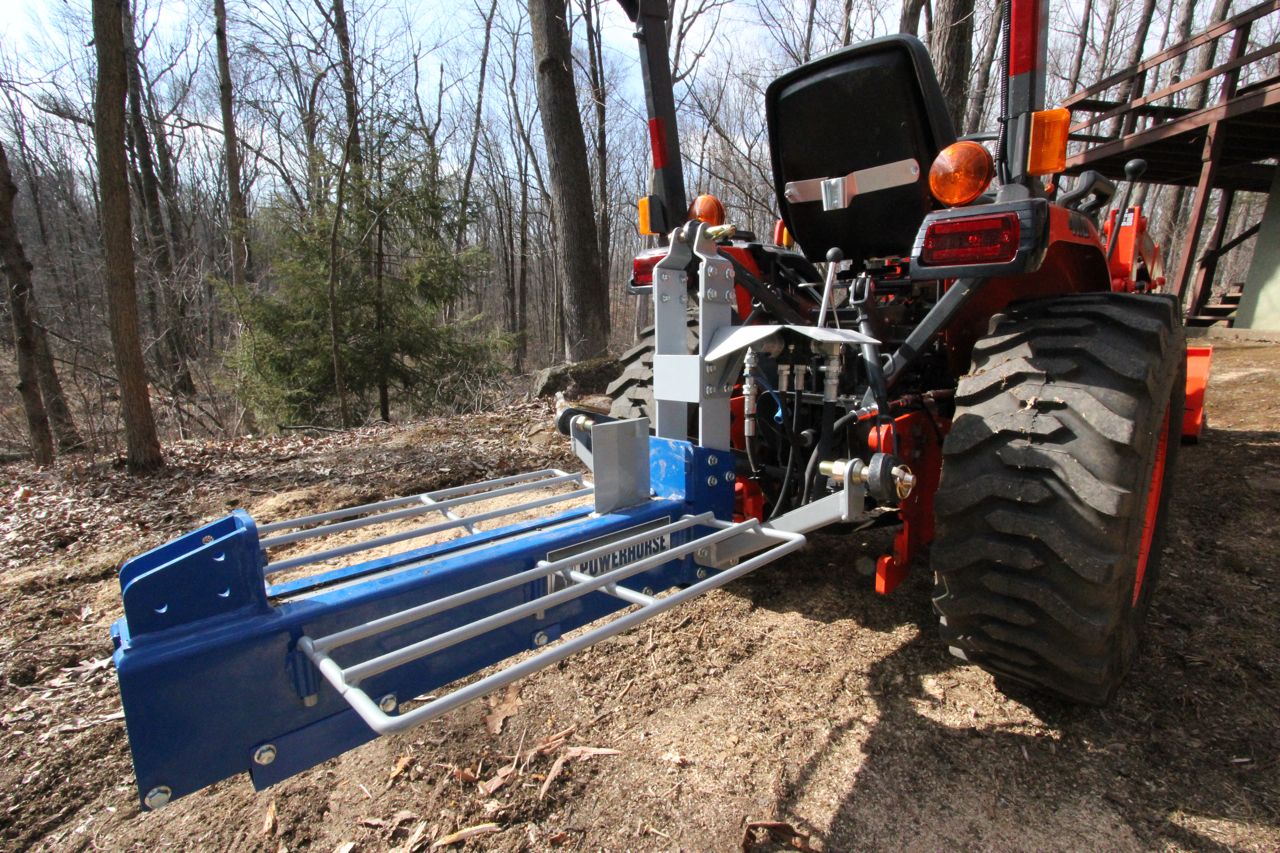

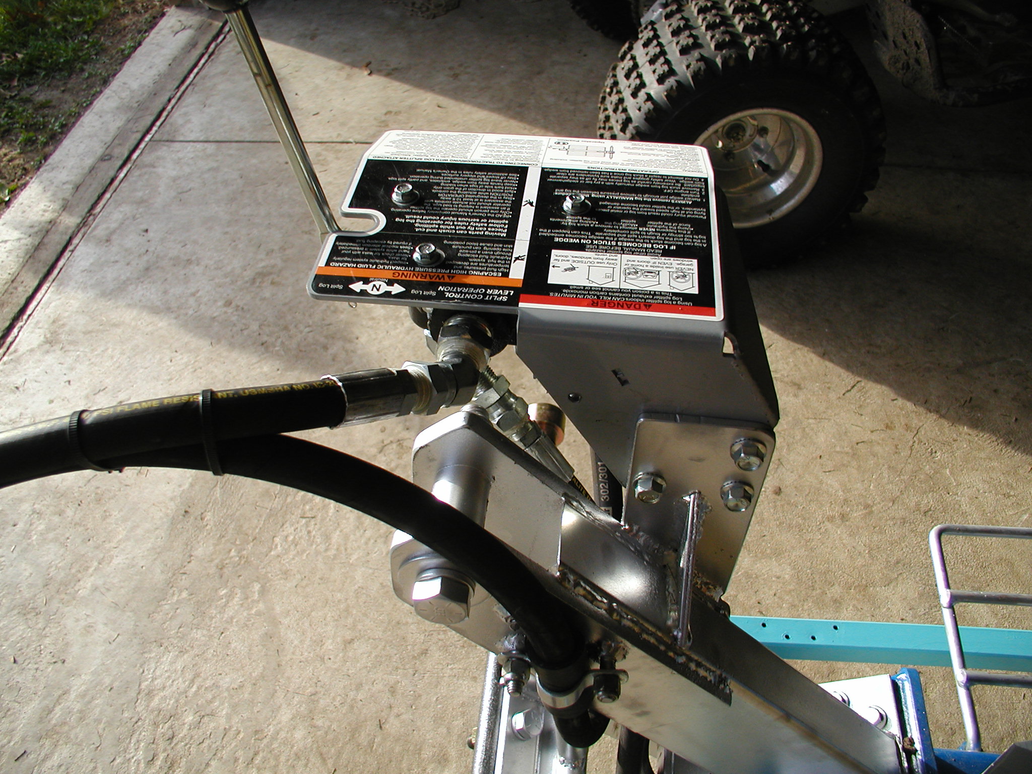

Great modifications! a couple of questions:
1. Did you have to remove the cylinder to make these mods? Since I can't see what the hydrolic connector configuration is under the unit, its tough to picture how you reversed the controls and hoses without having a bunch of extra hose under the unit.

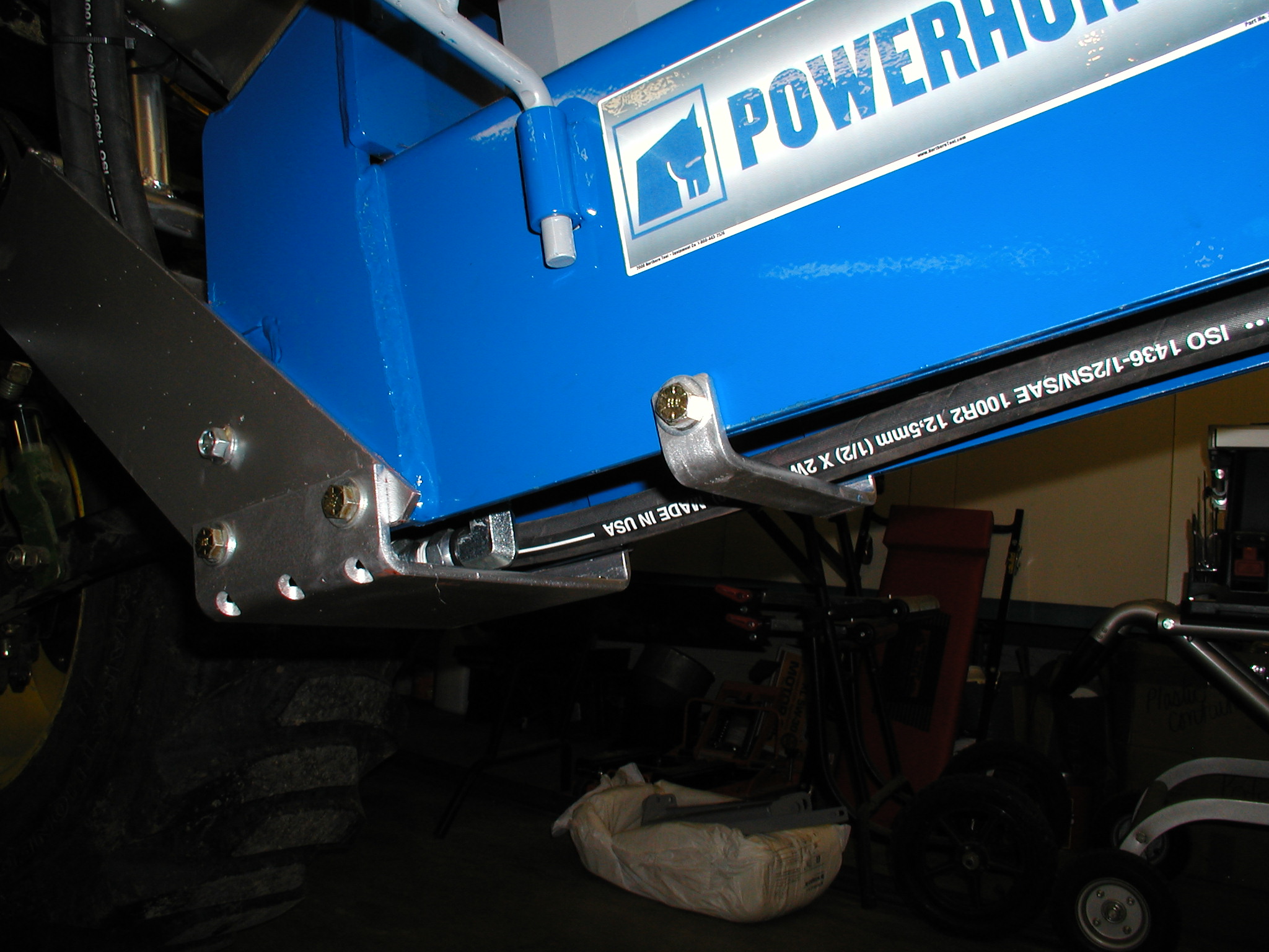

2. It is difficult to tell what you are showing in your 2nd pic. It looks like a U-bracket bolted to the bottom on the back of the unit, but it isn't there in the other 2 pics?? just wondering what this is?
I'm planning on buying the 20 ton 3pt powerhorse to run off of my John Deere 5420. I have dual pumps that produce 15-16 GPM. What kind of cycle time do you think I can expect with this flow rate?
Again, you did a beautiful job on your modificaitons. I'm not as proficient with a welder as that yet but this is a great project to practice on.
Thanks

Sorry for my slowww response, been kinda busy with medical junk for a month. Back in action now. Still slow, but moving in the right direction.
No, the cylinder stays inside the frame and all plumbing is done underneith. So my mods of moving the control to the front end simply requires the right-angle fittings on the cylinder to be oriented facing forward instead of backwards.
Yes, pic #2 is a u-bracket. I made three of them. Their function is to keep the splitter hydraulic fittings and hose from resting on the ground upon it is lowered all the way. The u brackets also keep the hose suspended up under the unit, so it doesnt sag down. The brackets bolt onto existing holes.
I can not be sure what your cycle time will be, but be sure to let us know after you measure it. Mine is fine for me, and I guess I have 9 gpm on the implement pump.

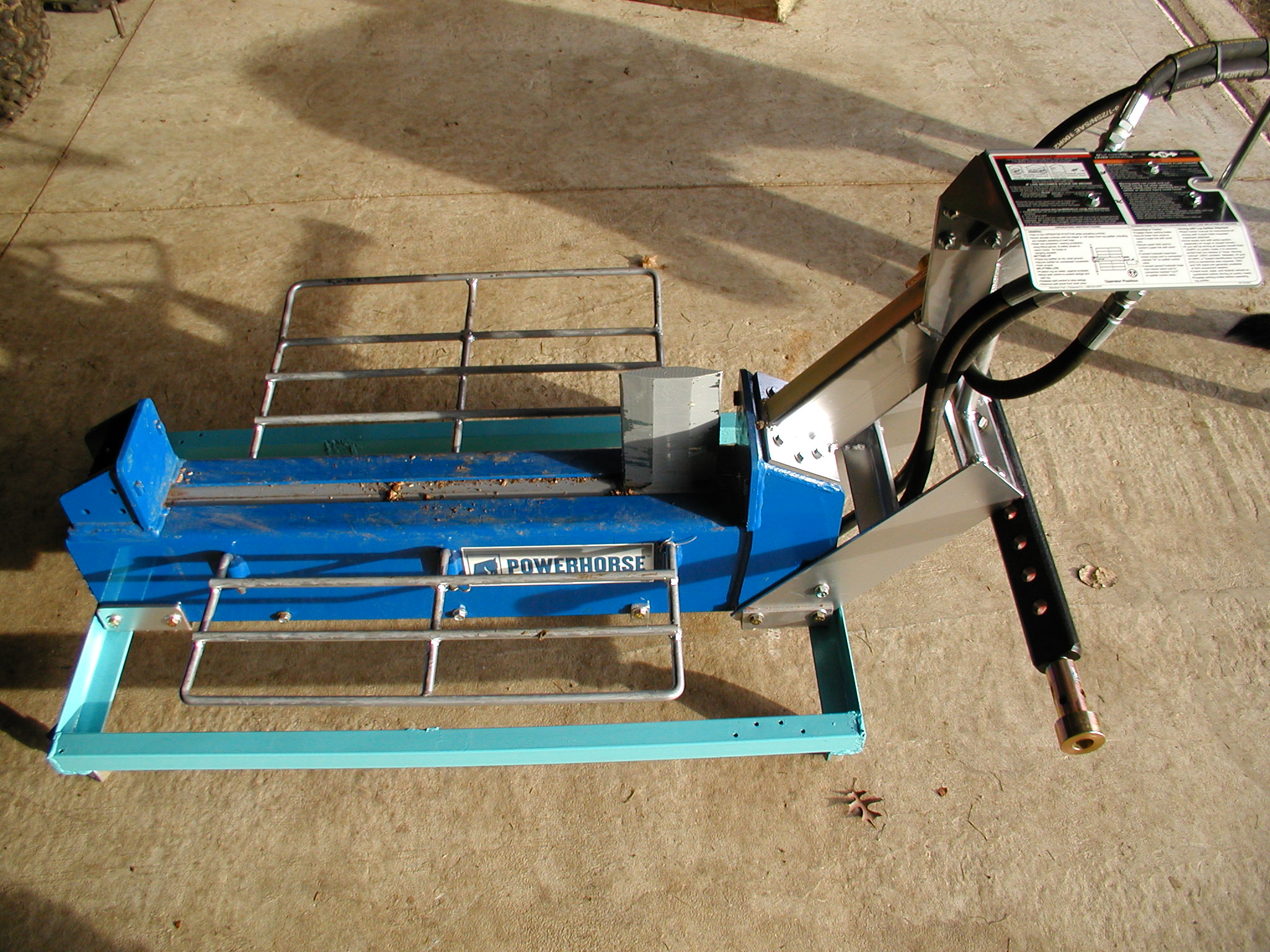

Finally, I went ahead and moved the control valve to the opposite side (now on the right side of the tractor) of the splitter, keeping it up at the front end of the splitter, but spinning it around so the lever is foreward of the control valve. This keeps the lever and linkage further from the splitting operation, both foreward and upward. It also required one new hose, shorter by a couple feet. Now, with the control on the right side of the tractor, I can stand on the right side to operate it, and without walking around the tractor or climbing onto the tractor, I can reach the three-point lift lever and engine throttle lever. This helps one-man operation greatly. I swapped the work tables then, so the smaller table is on the side I stand up next to. The tables just pin in place, so that change was trivial.
I finished a special skateboard for it too, for storage. Built with angle iron and casters, it allows the splitter to be rolled off into the corner when not in use.
I should be able to get some pictures of this stuff eventually.
   / Powerhorse 3 pt. log splitter design flaw #13
This new pic may show the channels better, the fourth one shown below. You can see in this pic how the hose and fitting would be touching the ground without the channel features. The other three attached pics show the unit as it exists today, with the control now flipped to the right hand side, and lever forward instead of back. I used it in this configuration for about twenty chunks of log, about two weeks before labor day this year, and it is a big improvement. It had made me worry about the wood coming up and hitting the lever and linkage when the valve was on the left side and facing back. So that is cured now. And it is really handy to have the control on the same side as the three point control lever. After all, the whole intent of the 3-pt splitter is to be able to drop to the ground to roll on a big log, and raise up to a nice working height so you are not bending over and fatiguing your back muscles, so moving the 3-pt lever happens fairly often.

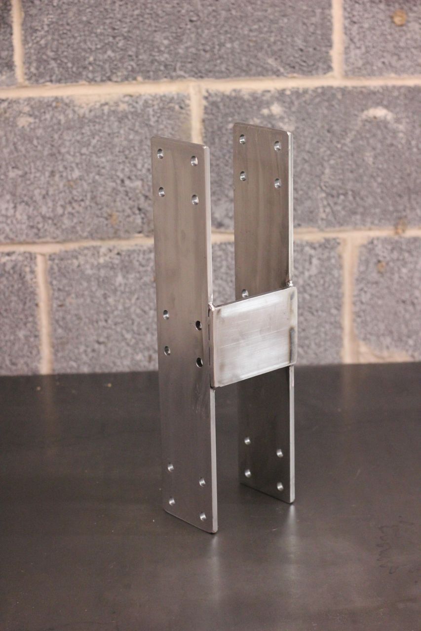

Inspired by Jim's modifications, I decided to convert the hitch mount on mine as well. But given that it was brand new, I didn't have the heart to take a torch to it, so I designed a simpler reversible conversion.
First the legs were turned upside down, this required drilling two new mounting holes in the frame, the only permanent change.
For feet I couldn't match Jim's nicely formed channel brackets, and instead just used 4 pieces of angle stock, mounting to the existing holes.

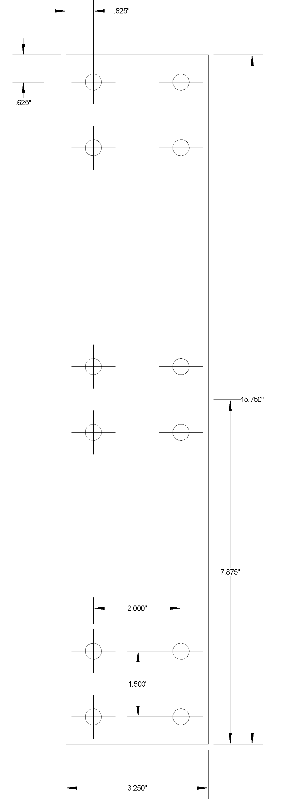

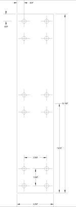

Finally for the top link attach point I fab'ed a vertical extension out of 3' of flat stock. The cross-brace on it is probably overkill, but it felt flimsy without it. Dimensioned drawing for the extension is attached.
I moved the control value to the vertical extension to get it a bit higher off the ground. The existing cylinder hoses reached just fine. The valve stick does hit the lift arm when the splitter is placed completely down on the ground, but works fine in every other position.
For a couple bucks worth of steel it makes using and storing the unit a fair amount nicer. Factory design should really be closer to something like this.
