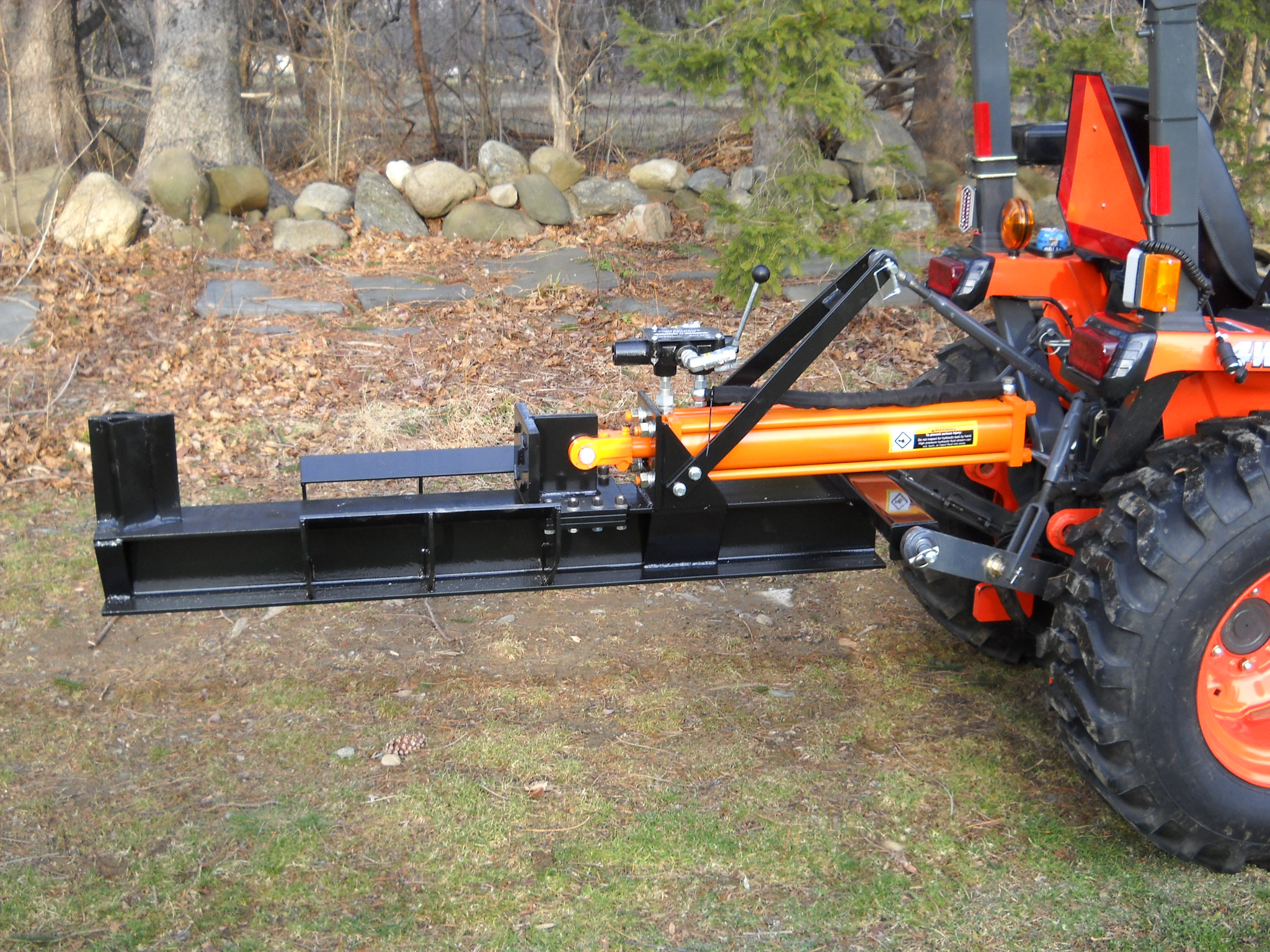

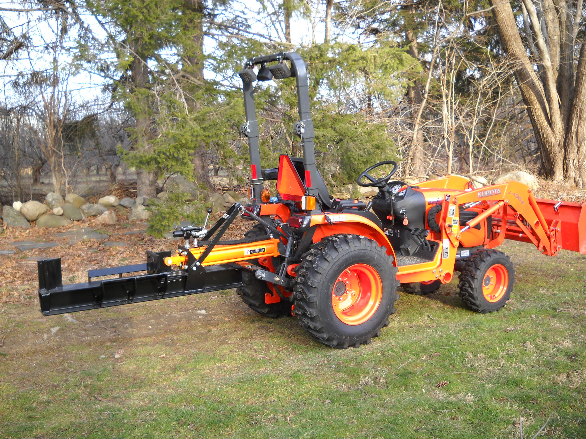

Absolutely true - however, I think the 3 pt vs stand alone depends on a number of factors for those (like myself) that only split a handful of cords per year the 3 pt makes perfect sense. I didnt want to shell out a lot of money and have another engine to care for so when harbor freight had their 3 pt splitter on sale from $499 to $399 it was a no brainer. Yes its made in china (14 ton splitter) but after a handful of cords it would have paid for itself and I have to say it works remarkably well!

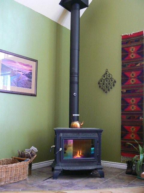

Have you used your Hearthstone much yet? They are made just up the road from my house and I got a factory second. It's quite a bit different than a cast iron stove, the heats not as fast but much more even and the stone really puts out the heat even after the fire has died.
Yes, I am on my third winter with the Hearthstone and it's fantastic. We burn about 12 cords each winter. It is used all day and night as I work from home mostly. Our dogs and cats curl all around the stove:)
It's one of the best things I have ever bought. I love it.
