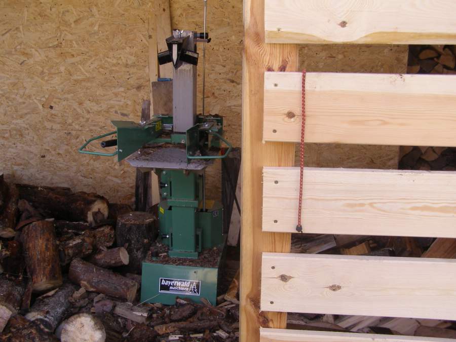

   / powering a log splitter. ideas? #25
