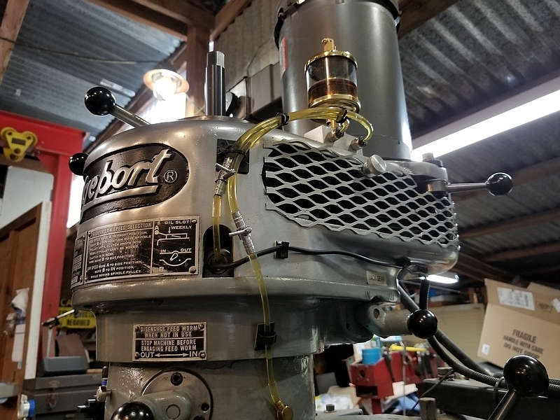

Speaking of electric and Bridgeports, are you running a 3-phase converter or a rotary phase converter? Or did you just stick a single-phase motor on it? (BooHoo)
Here's the J-head after I installed an auto-oiler. I've got parts and materials for a power drawbar but just haven't gotten around to it yet. :rolleyes:
