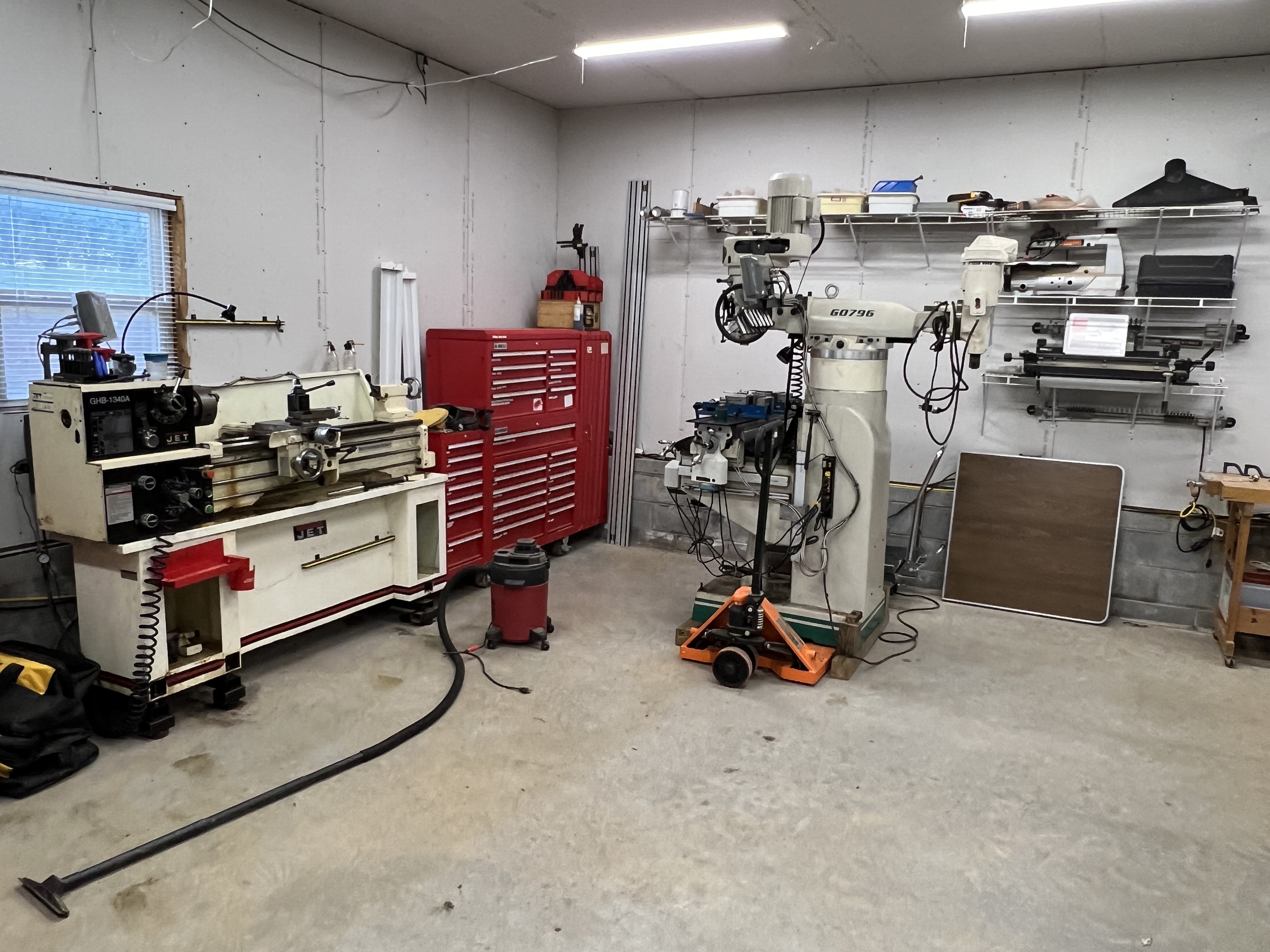

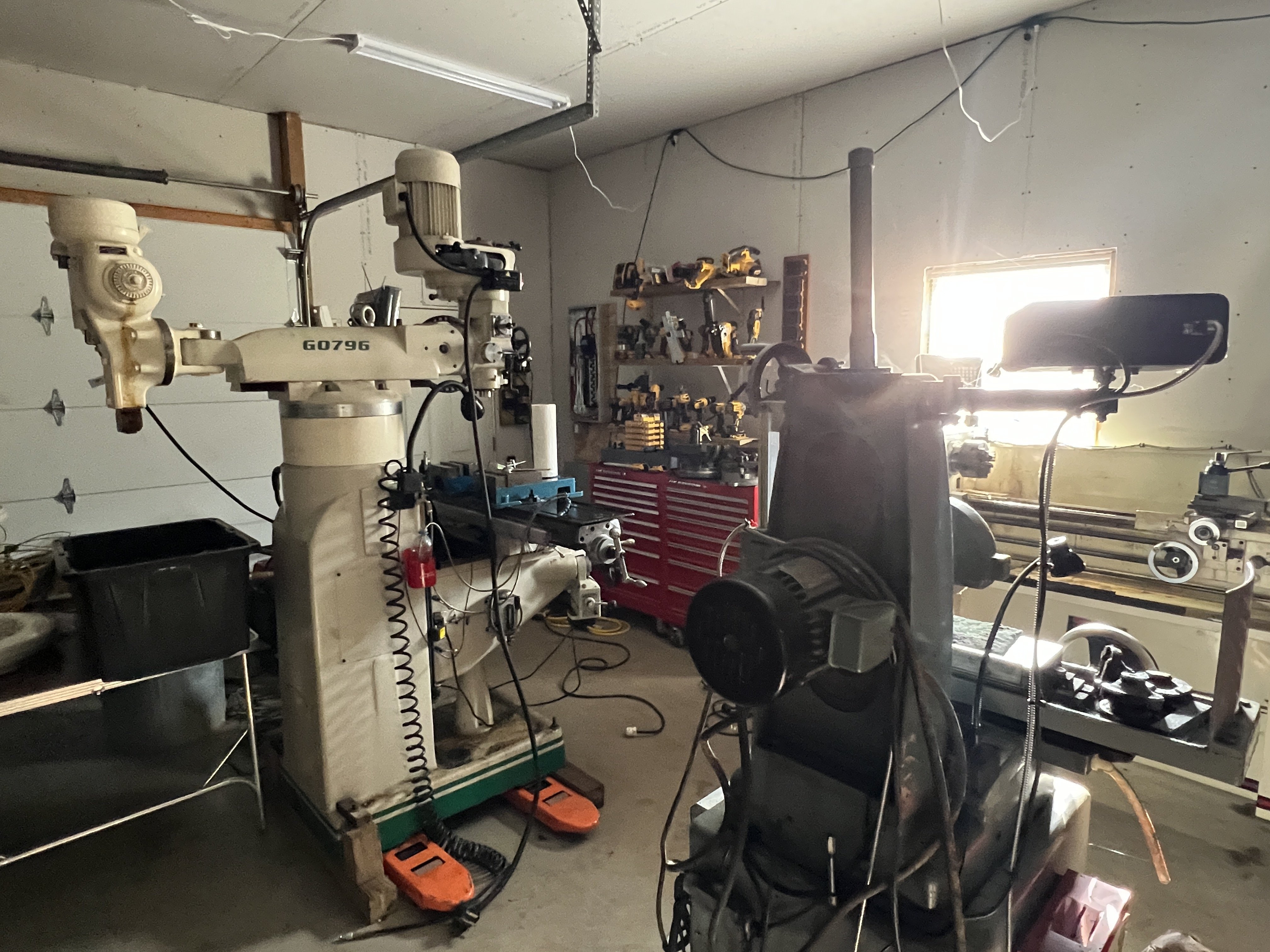

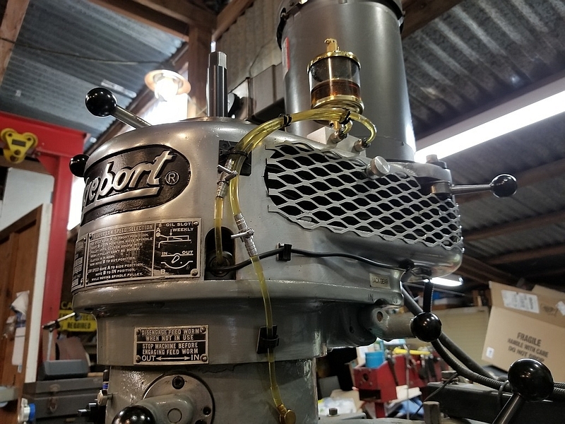

Speaking of electric and Bridgeports, are you running a 3-phase converter or a rotary phase converter? Or did you just stick a single-phase motor on it? (BooHoo)
Here's the J-head after I installed an auto-oiler. I've got parts and materials for a power drawbar but just haven't gotten around to it yet. :rolleyes:
It a clone, whimper, but it's mine.

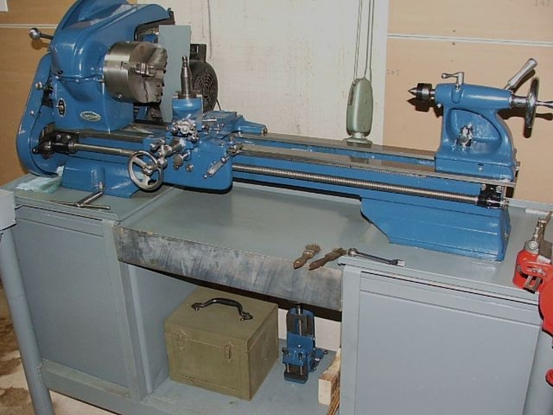

That's how I feel about my 12" Atlas-Craftsman Lathe. 🫣
Beautiful, it's sad that Sears died and still amazed by all the things they sold. Minibikes, sewing machines, prefabricated homes, even farm field equipment.

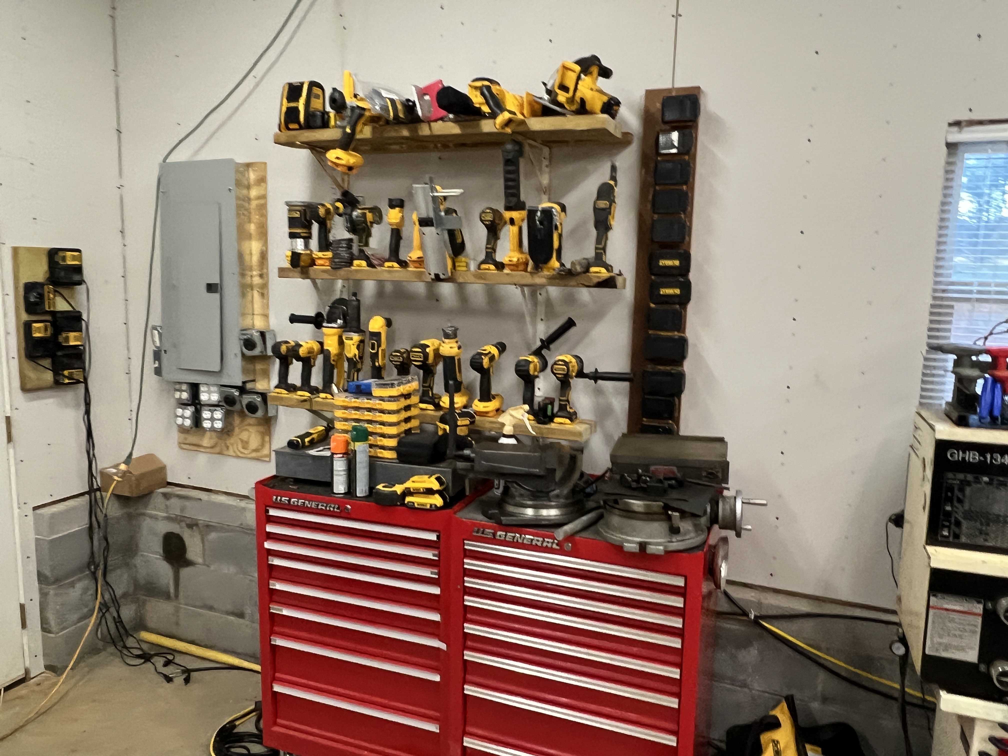

Well I finished the panel today and had it inspected. Because of the devastation not far from me power in western North Carolina crews are still busy and will likely head south to Florida in a few days. So generator for now but taken everyone's advice consensus being a separate meter.
