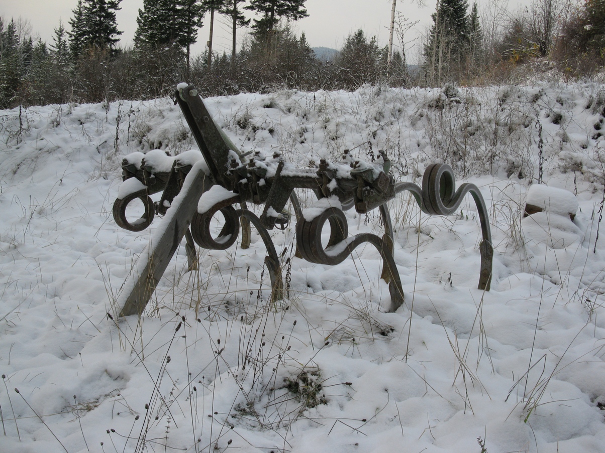

I use a coil spring cultivator with straight shanks as a ripper. Here is a photo:
I think it rips better than a box blade. It goes deeper and the teeth can flex over and around large boulders. It will bring soccer ball sized rocks to the surface.

I cannot imagine that penetrating the hard packed clay that we have here. Perhaps with looser soil, it would do a good job.

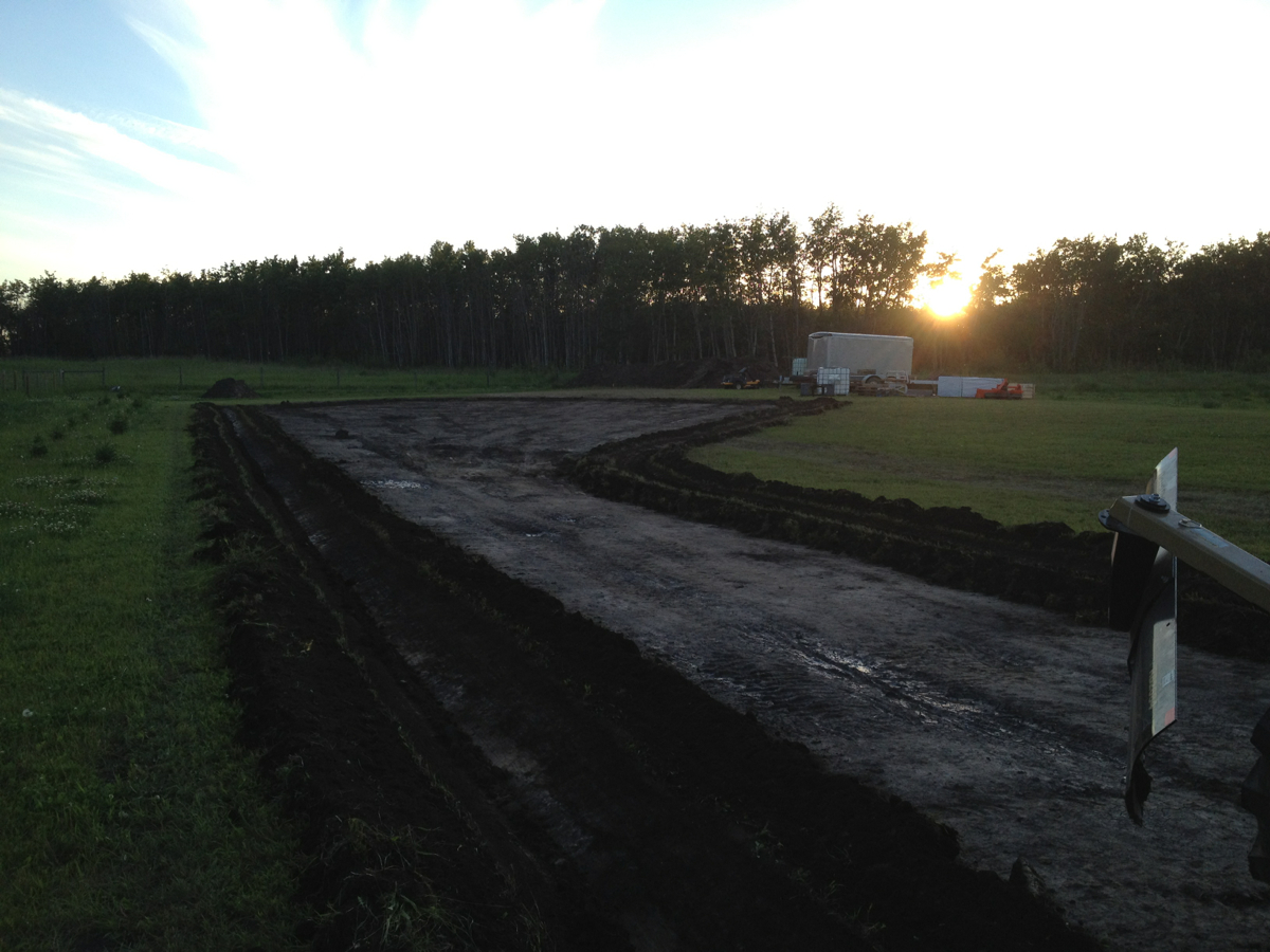

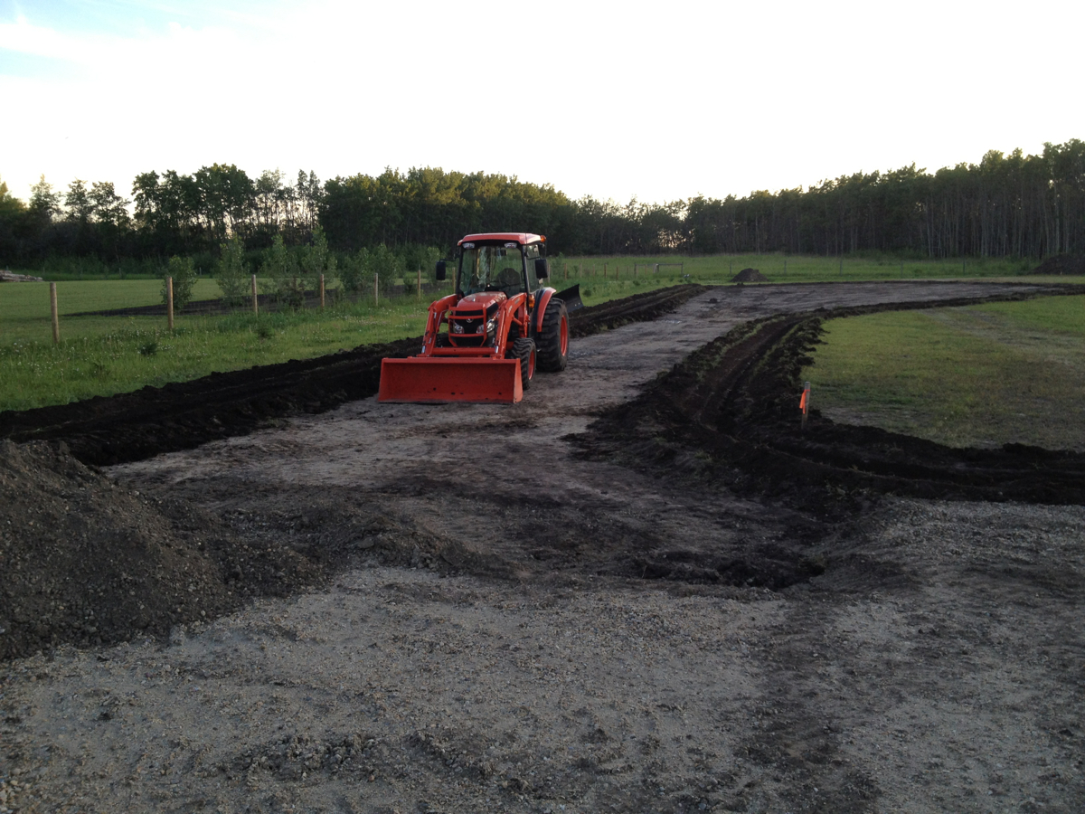

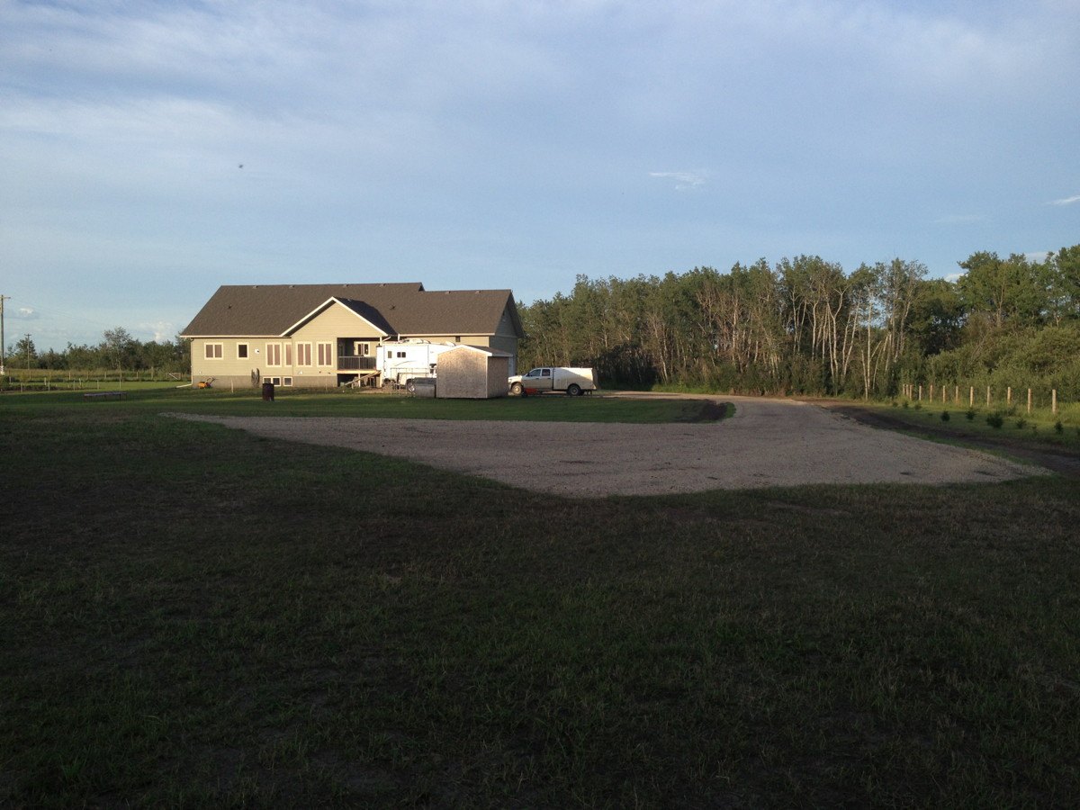

I have a L3940 cab. Bought it new this fall with a 72" smooth material bucket. My largest task this summer was to remove the top soil from an area of our yard, haul in 3/4" crushed gravel, and build a giant parking/turn around area. I had to use my RTR 66" tiller to loosen the soil and then scoop it up. Then I picked up a new 72" SS tooth bucket. Huge difference. Did not need rototiller anymore. Was it as good as a skid steer, no. But it worked for me. I did have to add 45 gallons of rear ballast to the tires, even with the tiller on. Definately get a bucket wider than the rear tires. I would do it all over again the same way.
I have tried to dig through clay, does not work near as good as top soil. Keep in mind the top soil was packed rock hard for the last 5 years too. For clay I found it easier to till up first.
Bucket is heavy, tractor could barely lift it full of soil. But the long flat bottom makes it easy to dig with control.
Just put her in 4wd, low range, and go...
