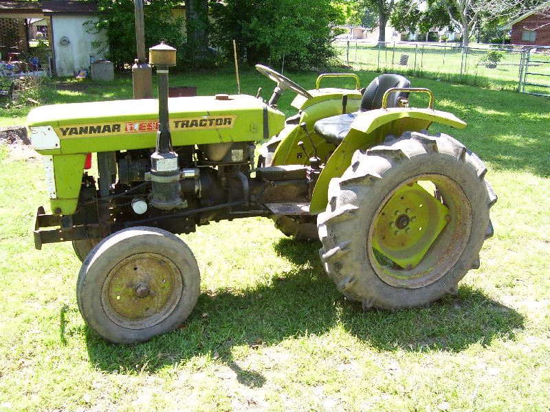

Mark, you could buy the YM240 that mike has for sale, it has the pre cleaner on it.
Danny
