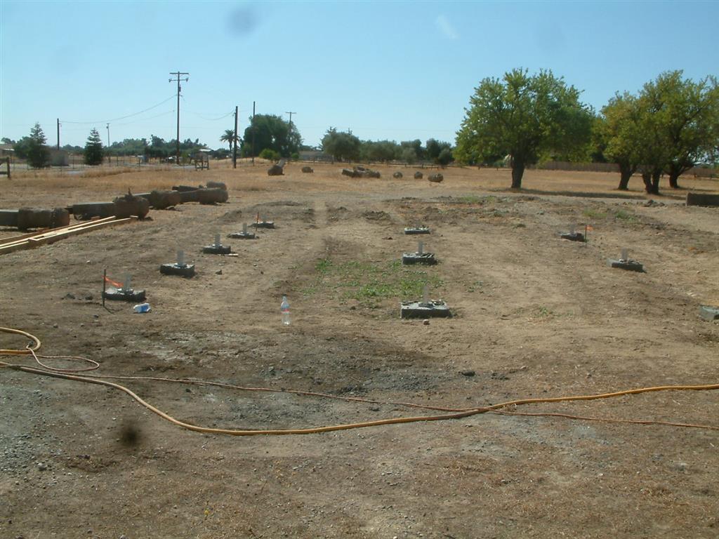

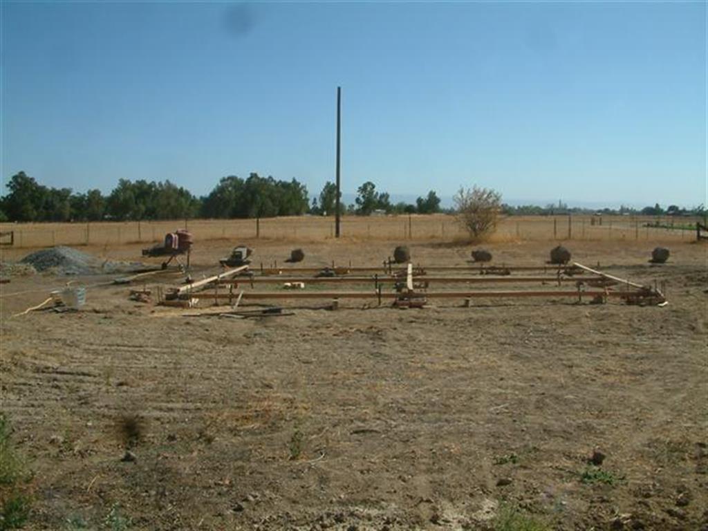

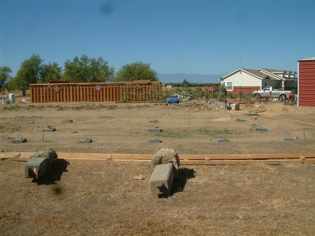

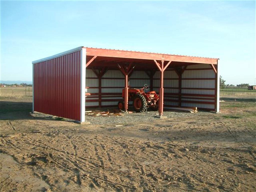

It depends on how tall you plan to make your columns. If you just want to raise the bottom of the posts 6 inches or so above ground level, then I'd just dig holes and pour concrete around rebar and Simpson post brackets. That's the method I used to build a 20x28 ft equipment shed a few years ago.
Equip shed foundation-1 (Medium).JPGEquip shed foundation-2 (Medium).JPGEquip shed finished-1 (Medium).JPG

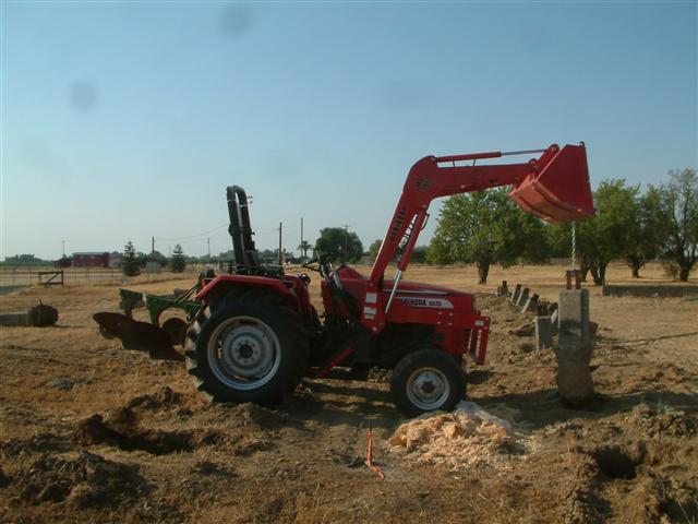

If you want taller columns and you can buy ready made columns, go that way. Other wise you'll have to custom build them as you indicated using forms. To clear the area for that equipment shed, I removed a few dozen tall concrete columns that used to support an old dairy barn on my property (it burned down in the 1950s).
Needed my Mahindra 5525 tractor to handle these posts. Gave them to a neighbor who used them as the foundation for a new pole barn on his place.
Good luck
