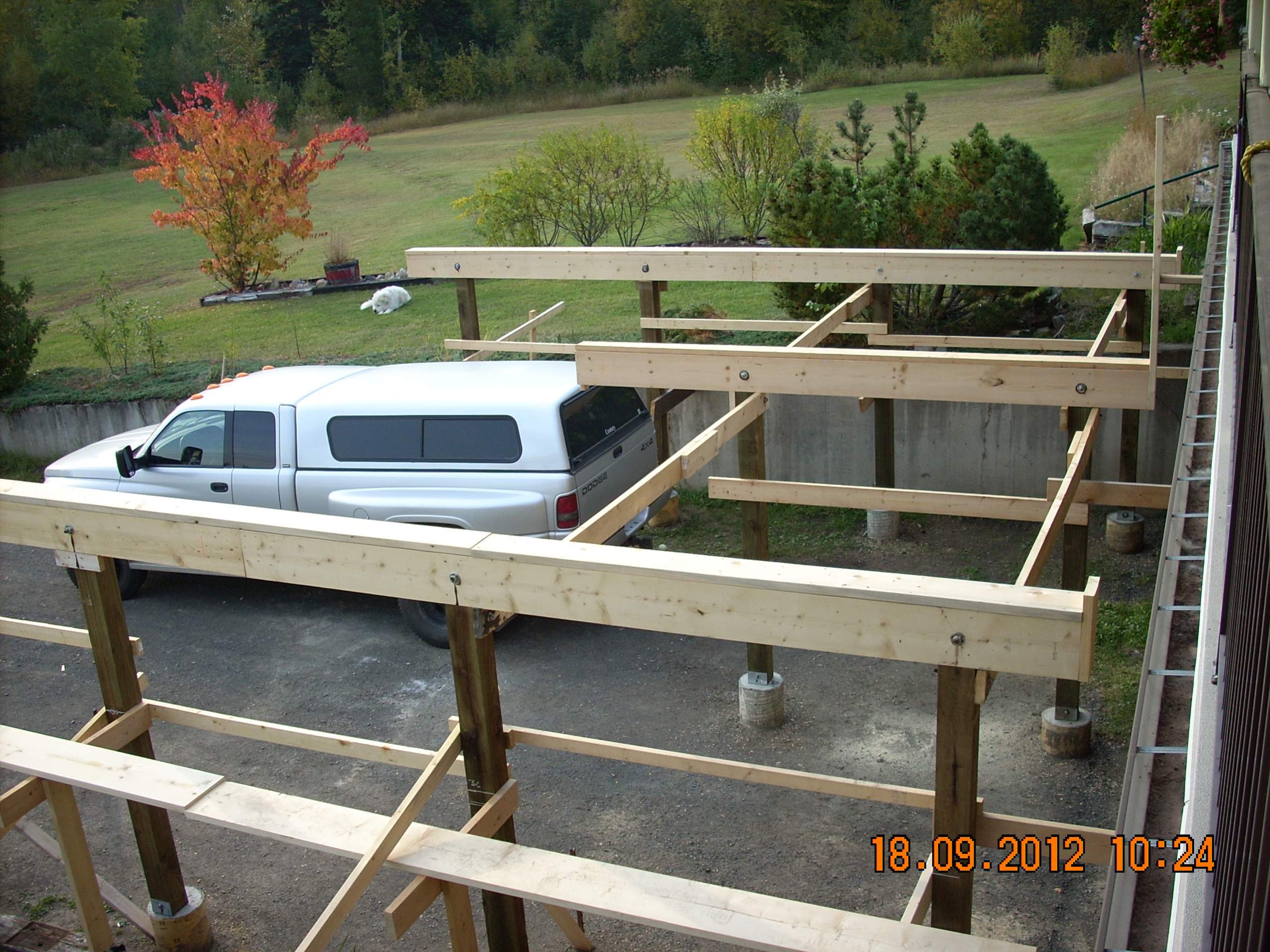

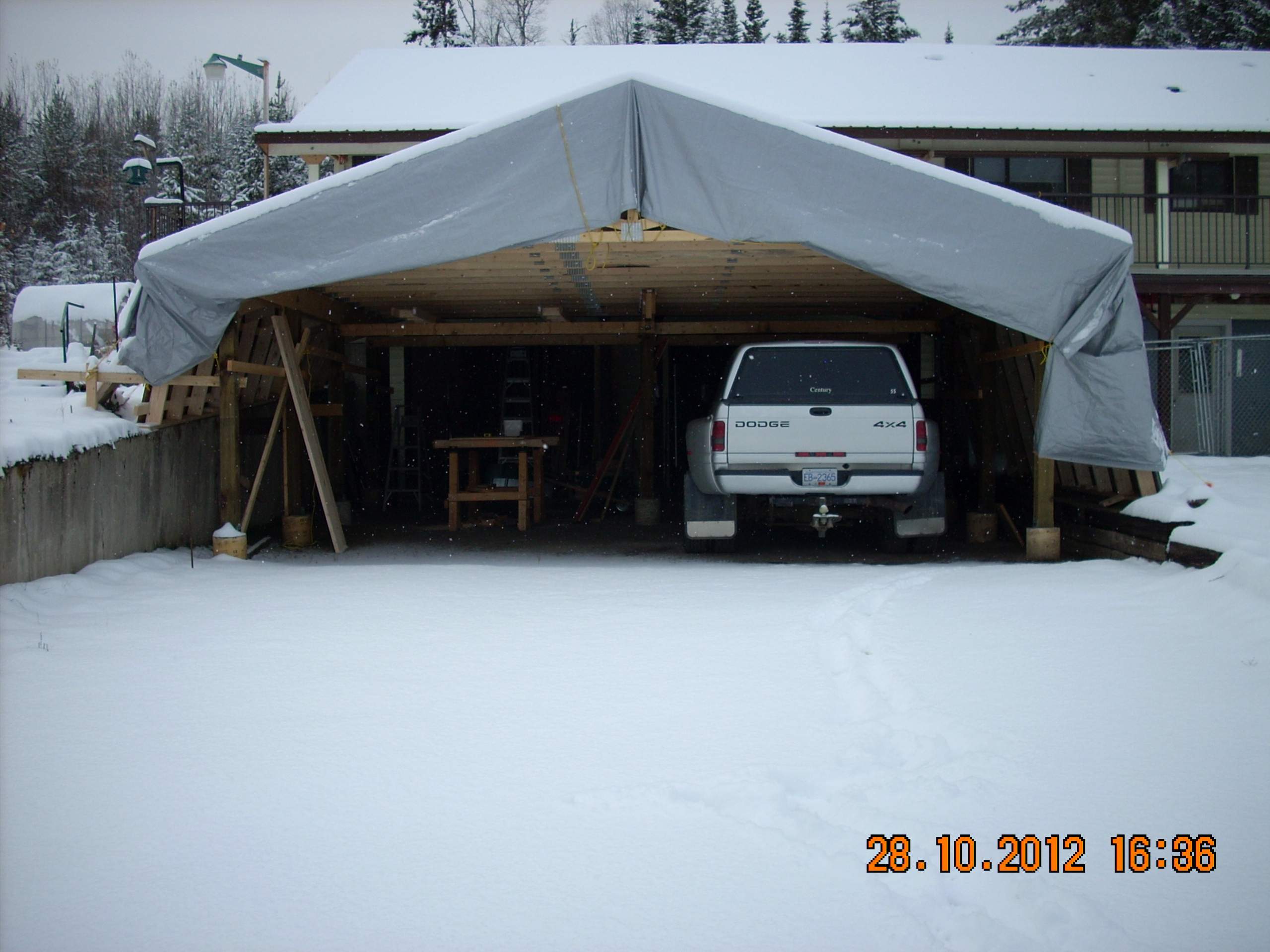

When I built my double car port I used the 12" diameter sono tubes as previously described. I used my post hole digger (12" auger plus 24" extension) and drilled down as deep as I could. The sono tubes fitted into the holes nicely and they were all 4'6 between 5'0" deep - local code calls for 4'0" below grade for frost.
I made my concrete columns stick out 16" above grade and put in three pieces 5/8" rebar 6 1/2 ft long into each footing. I filled each sono tube to the predetermined height ( took around 11 bags of concrete in each tube 3,000lb mix)and added a 6"x6" Simpson post base on the top. The poles I used were 6"x6" treated lumber eight feet long. With the other framework and roof trusses, the whole lot came together nicely.
It is now over two years with a temporary roof covering and all looks good.. This coming summer a metal sheet roof covering will be installed.
I know this does not compare to what you are attempting, but might give you something to think about.
