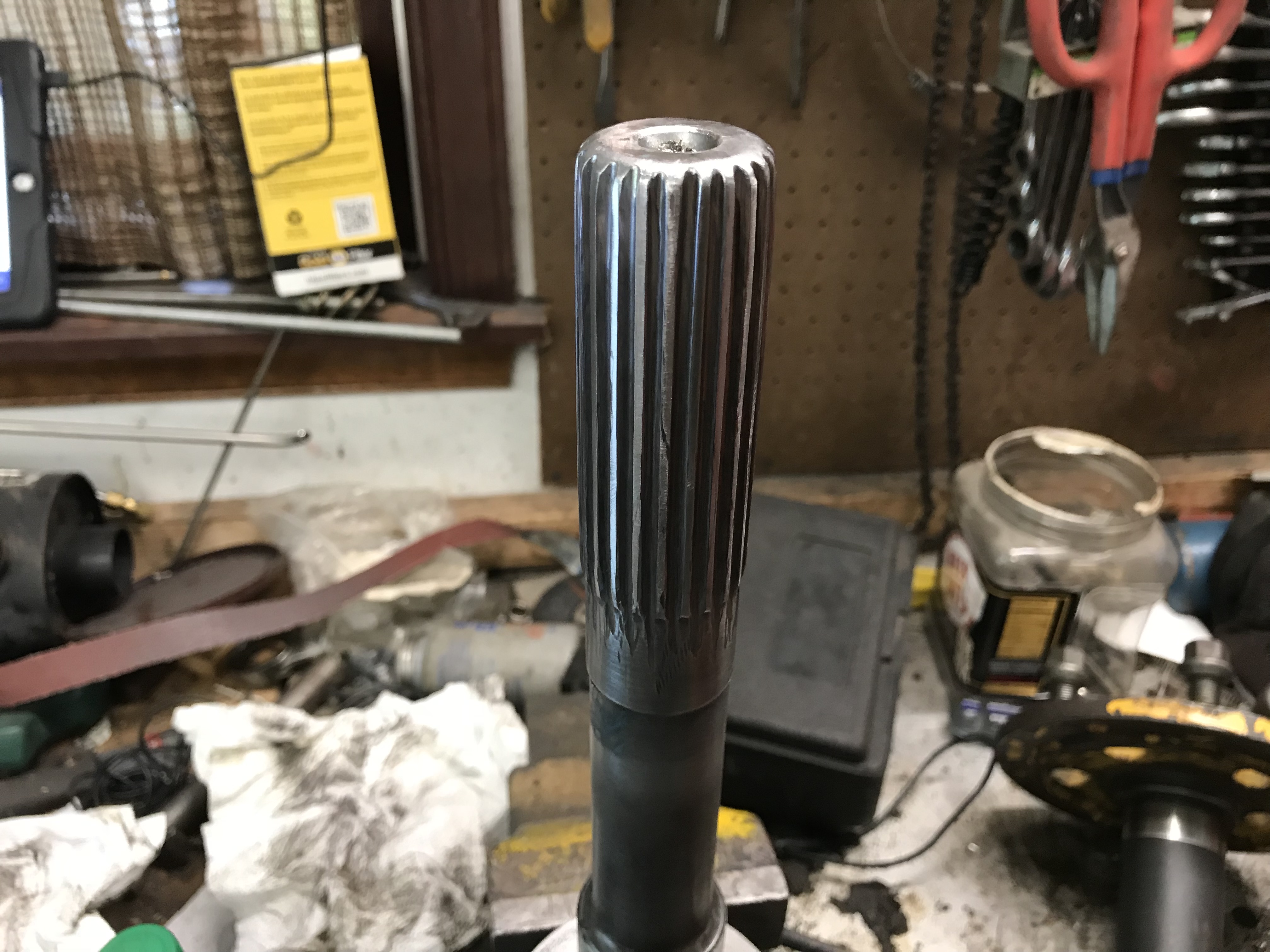

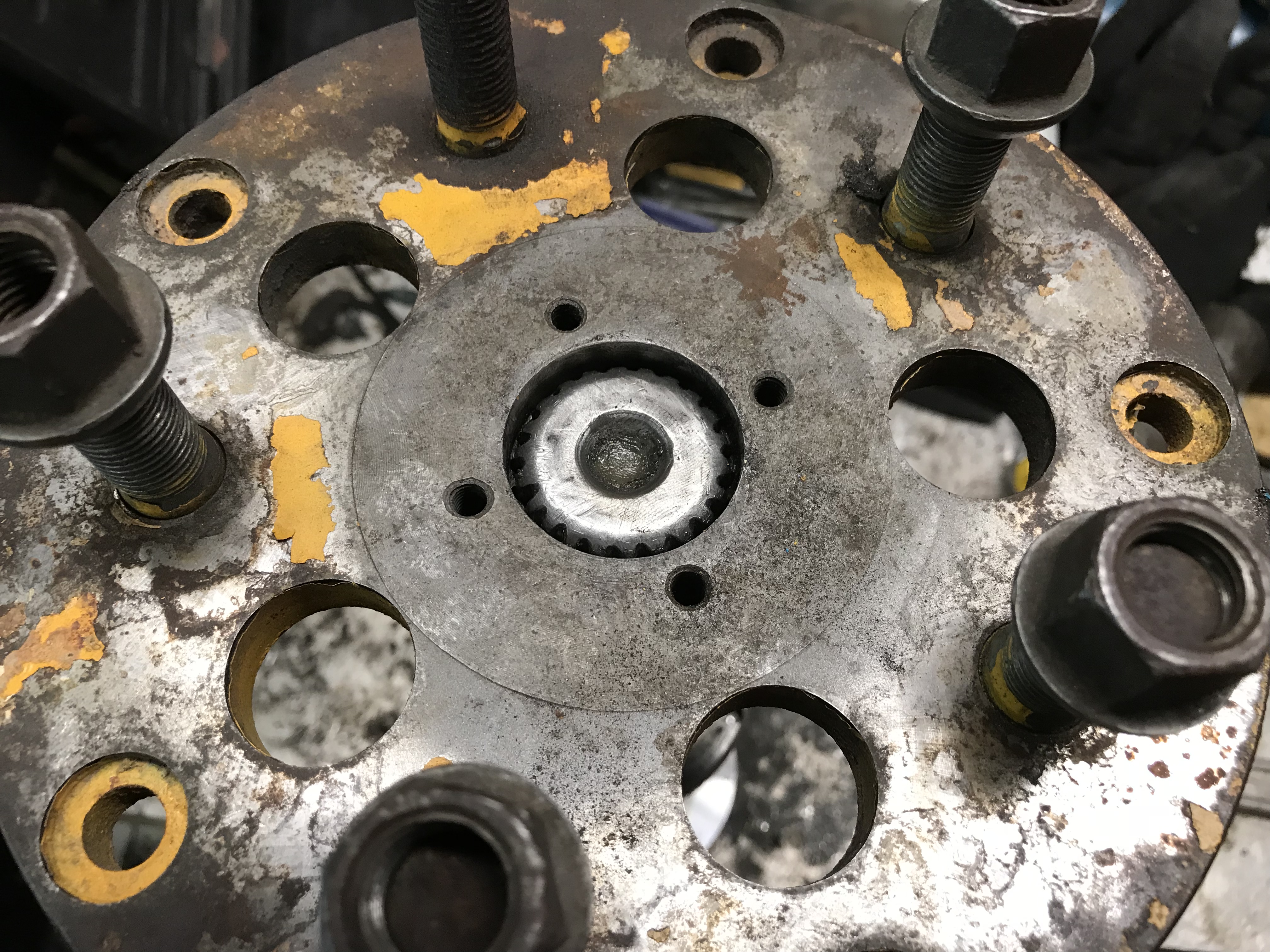

   / Predator 425D HEELLPP ! #13
Just putting this out there in case anyone is running into this problem with broken or missing axle shaft spline end. The spline is a metric 35 mm x 22 spline on the outer end of the axle shaft. I’ve been unable to locate one. I priced having one made but it was $2400.00 just for the splined shaft. So I started researching. I do. Or have the part number on me but if anyone needs it I’ll get it for them. Spicer makes a weldable mid ship tube for a driveshaft . It’s not metric but standard. It is also a 22 spline . It comes with the anti friction coating (blue) very hard to remove. With some patience an air grinder and or a dremmel. It can be modified to fit. I just finished doing mine. The cost of the shaft was approx $60. A machine shop wanted $800.00 to modify the splined shaft to fit the hub. Now I will take it to a local driveline company to get an h yoke and 2 weld on axle yokes. I will attach pictures if anyone is interested. There is no information left on these things. Corporate office of bobcat acknowledged they made them obsolete and purged all the parts and manuals. Hope this helps someone in a bind like I was.
