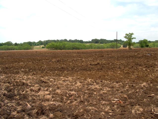

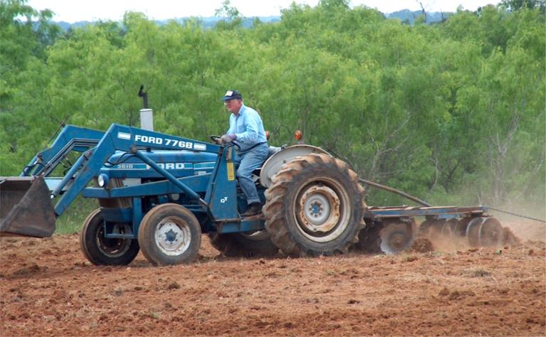

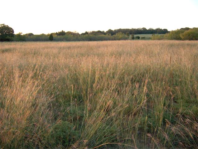

Alan0043, I planted 10 acres of native grasses last spring (April). The advice given so far is good. I planted native grasses because #1 I like the way it looks, #2 the wildlife love it, #3 it is drought tolerant, #4 requires no fertilizer, #5 I only mow it once a year, and flash graze it the rest of the year.
After dozer root plowing and limp & root raking and large disking the land (all of which you can skip) my dad disked the land and drug a 10’ railroad rail behind the disk with his tractor. See attached photo. To get the land more level I should have drug cattle panels around the field like I did in the back 5 acres but there were too many mesquites in the field and I was getting tired of flats. I like dragging the cattle panels in the back 5 because they were more rigid than chain link fencing and really knocked down little hills and mounds and made the ground smooth and level. I had extra cattle panels around so for extra weight I stack three on top of each other.
After planting the seed (by hand) I rolled the land with my Farmall A and a homemade roller made of a heavy steel pipe surrounding by used golf cart tires. I’ll attach a few photos of the front 10 acre native grass field, during planting and the fall after planting. Good luck with your grass field!
TXDon

   / Prep land for grass seed #18
Late Fall grass field.
