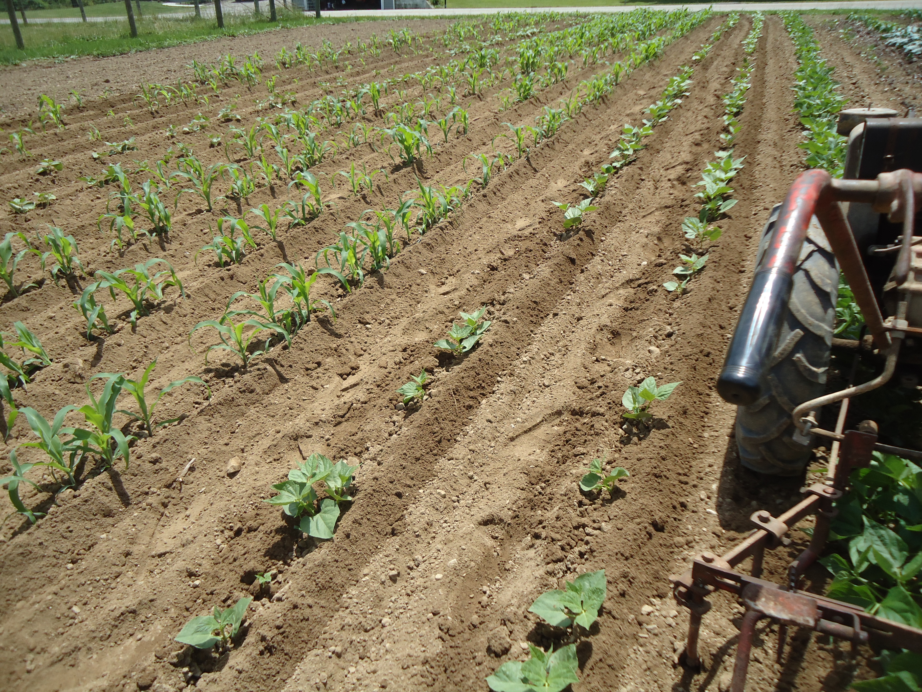

You may want to consider a smaller cultivating tractor, even an older 2-wheeler. You may laugh, but there are folks tending 5 acres of produce plots with small 2-wheel tractors, all over the U.S. The hot items right now seem to be the Planet Jr. tractors, and David Bradley's. I prefer the David Bradley's because of taller tires, and you can cultivate until plants are nearly tall enough to shade in between rows, to slow weed growth. And, you don't need to cultivate deep. I prefer to cultivate at maximum, 2-1/2" deep. Just fight the seed bank in that top layer, any deeper, and you're just pulling up more weed seeds to sprout. And, more than likley, depending on the rain, you'll need to do that every 3-5 days. It's much easier to killweeds in the, what I call "button stage", when weeds first emerge. Normally, you'll see 2 tiny leaves coming up first. They will have thread like roots on them, and be in that 2-1/2" top layer of soil. Cultivate in the morning, after the dew dries off, and let the hot afternoon sun kill them. Or later in the evening when it cools off, IF they aren't calling for rain the next day, and let the sun kill them. The first place you'll notice weeds coming up after cultivating, will be in compacted soil of your foot prints, if you're hoeing, or just walking through checking your crops. It may sound strange, but here, Ant's let me know when it's nearly dry enough to cultivate. When I see them making hills in the soil again, it's time to cultivate.
Just plant your rows in spacing, so as to cultivate, with whatever you use. I don't see the location where you live, so hard to say what is in your locale to do that with. I saw you mention tobacco, or hemp, so I'll assume in the South. There should bequite a few small tractors that were used to cultivate tobacco, like Farmall Cubs, or Super A Farmall's, up through a Farmall 140, with 1 row cultivator set ups. Allis-Chalmers G's are becoing a hot item once again for produce growers, but are pretty pricey.
