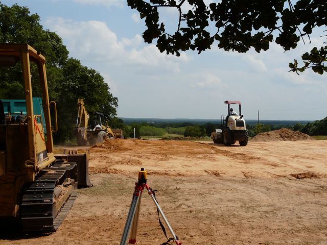

Make sure the soil is compacted when you are filling in the tree holes.
After all organic material (grass and roots were removed) We had to raise the ground level for the foundation 18" on one corner. We used a vibrating compacting roller and when it was finished the soil compaction was tested. The compaction of the soil should be the same as undisturbed soil.
This ground prep is for an engineered slab that uses tension cables.
The pile to the right was the organic material in the topsoil.
