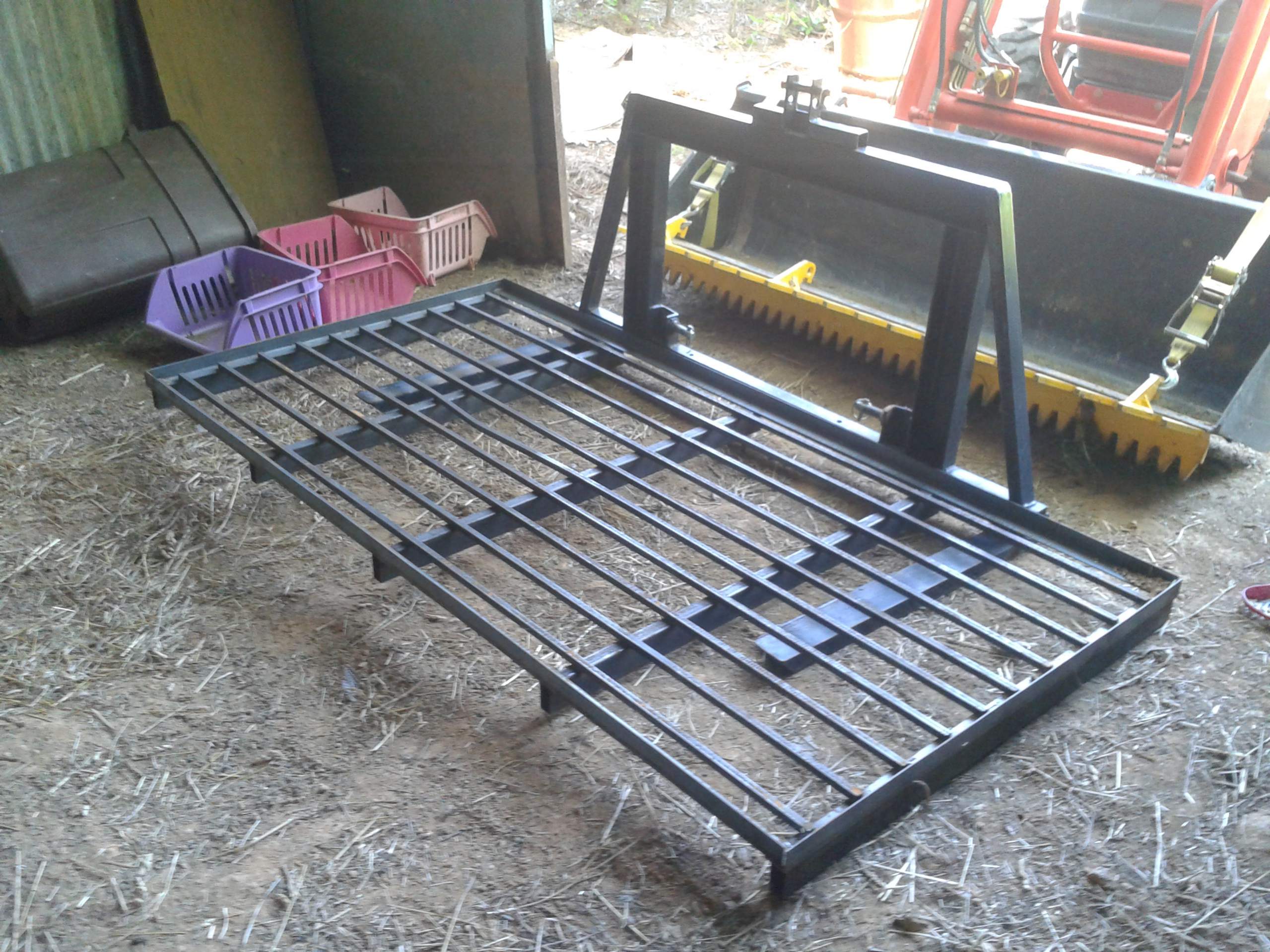

Zebra Five,
1 - I am estimating, I really have no way to weigh these, but A is between 350 & 450lbs according to TBN guys who estimated it. B might be 100 lbs, probably more like 75-80. C is likely over 50 lbs, but it is awkward to hold (I'm using 50 lb feed bags as my measure). I am really just guessing.
2 - B (the carry all) is 4' 9" wide and only 33" deep total (<29" forks)
3 - I think so, but I like the idea of feet regardless.
4 - C (the rack) is 7' 1" x 3' 7.5" It would not be much bigger than the 7' HD Box Blade which is my only real other ballast option. I'm not squeezing between that many trees, and I need the ballast so I can grapple, which is typically in spaces MUCH wider than 7'. I really do not want to cut it down, it is not really even 6" on each side wider than my tractor.
5 - 3 pt lift is 2,493lbs (24" behind)
I like the idea of bolting A (weight) between toplink and bottom, but I thought lower like as one of the feet on the bottom was better.
I like the idea of hinging the rack, but I think it is almost useless as it is, without sides.
Other than manuverability, why would I make it narrower? I don't see the value in cutting the rack down to narrower than the tractor other than manuverability.
Really My vision is I only have concrete (7' x 3.5" x ?") maybe 12" or less thick, with a single drain, and wooden (like a stake bed) sides maybe 20" (basically three PT 2x6" boards with space between them). The saw scabbards would be between the tires and the box, same with the tool PVC pipes.
David
So you have approx 500lbs so far. Then you need 600lbs more to make 1100lbs
The width of the rack you say will be no problem.
I would take A, B, & C to a welder. Have feet welded on to the carrier. Have the rack welded to the carrier. Have some scrap steel welded to the rack in proper place to bolt A to rack from bottom. Scrap steel is to span carrier bars. Will need holes for weight bolts.
In your vision for concrete (7' x 3.5" x?) did you mean 3.5' NOT 3.5"? If 3.5' your concrete will only have to be 3" thick to make 600lbs.

ZebraFive,
Yes, 7' x 3.5' is what I meant.
If I bent rebar into a "U" shape and had it welded on, would that work to hold the BH weight?
What should I use for a "floor" to pour the concrete onto, atop the rack? PT Plywood? Plastic paneling of some sort?
Thanks in advance.

ZebraFive,
Thanks in advance.
Thinking on the fly here...
Place plywood UNDER the floor on supports, build form around box, pour concrete, dry, remove plywood. Concrete is the floor.
Place large allthread/bolts/pins in the form for C that would point TOWARDS B to join with newly drilled holes in B for Quick Attach capability. Then, you still have B as a Carry all.
Maybe place upright pipe/channel iron/? in the form for C before you pour the concrete so you could use removable panels as your utility box. Maybe different setups/panels for different jobs?

Are you suggesting encasing the rack entirely in Concete? Hmmm....
I would expect the concrete to be subject to damage when I drive poorly (happens from time to time).
I was thinking I would use a sheet of PT Plywood and just leave it there between the rack and the concrete. I would run angle iron in the corners, and 2 x 6PT boards up the sides.
I need to come up with some feet.
One of my concerns is the carry all only stick out 29" so it just barely goes past the halfway point of the rack (Item C). Does that make it unstable?
Just thinking out loud folks...
Thanks to all for their assistance.
David

I was thinking the floor would be concrete with "channels" embedded for your side panel stakes to slip into. That said, I was also thinking you could make up different side panels for different projects and they could be interchangeable based on the daily need. I'm really not a fan of single-use implements if I can get around them.
Based on how you embedded the channels, your side panel(s) could overlap or hang down over the concrete base and provide "some" protection maybe?
Yeah, I looked at the length of the forks and was thinking you'd be over balanced also. Maybe make up some extenders of some kind, or bolt them on the bottom of C, but I can't get my brain wrapped around that yet.
Overall, I'm just thinking of keeping the 2 separate with some kind of Quick Attachment capability and providing multiple uses for C.
Please feel free to disregard any/all of these suggestions. Honest, it won't hurt my feelings any :laughing:

ZebraFive,
Thanks in advance.
Since your weight A has holes in it I would bolt it on. You could determinte where the bolt holses need to be and put some PVC tubes in the concrete for the bolts to go thru. You may want to put four PVC tubes in the proper places to bolt the rack to the carrier.
I would not pour the concrete on top of the rack. I would put the plywood below for the form. If you weld it to the carrier first, just cut three pieces of plywood to make a bottom form.
This makes good sense, at least for the weight (I'm thinking about making a rig to add it to my stump grinder also, so protability is good).
I'm not sure I follow this one. I THINK you are suggesting part of the rack will be INSIDE the concrete when finished. Right?
Thanks,
David
