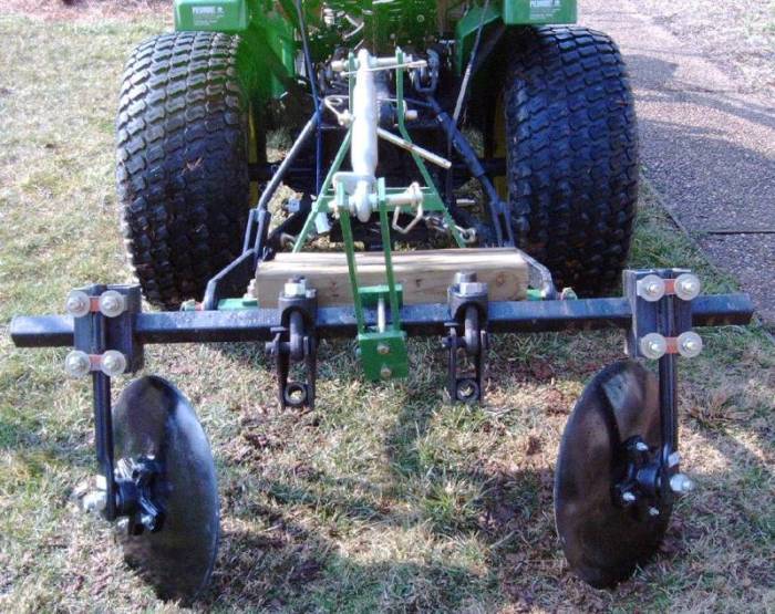

You can buy what you need from Agri Supply: a "keulavator" (e.g. 3ph tool bar) and a couple big discs. Set them up like I did on my JD M toolbar shown in the picture. Makes perfect raised rows. Then never till them. Just use row crops or mulch.
