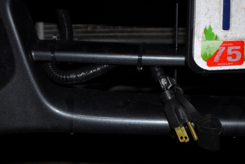

Final thanks to all for the tips, and a couple of photos, as I know they are very important :D Car is headed up north after the holidays.
What the heater looks like from the front. Hard to get an under hood view. Have given instructions to use heater starting at around 0 F/ -18 C, for about 20 minutes, and bump time to 40 minutes when it gets to -20F / -30C. Even if it's not needed to get car started, should help with lubrication in the first few minutes of operation. Considering we try to get about 300K miles out of our cars, small price for a little extra engine protection. Also went to 60% antifreeze mix, and Hondoo even gave me a little decal that goes around radiator fill tube noting the 60% solution.

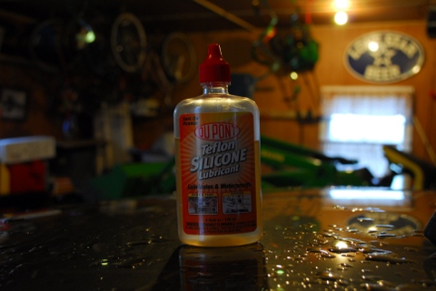

Here's what I used on the gaskets, worked really well. Dupont Teflon/Silicone as 3930 Dave suggested. Think it was 3.99 @ Lowze. Also did the window tracks with a small screwdriver wrapped in a cotton rag.

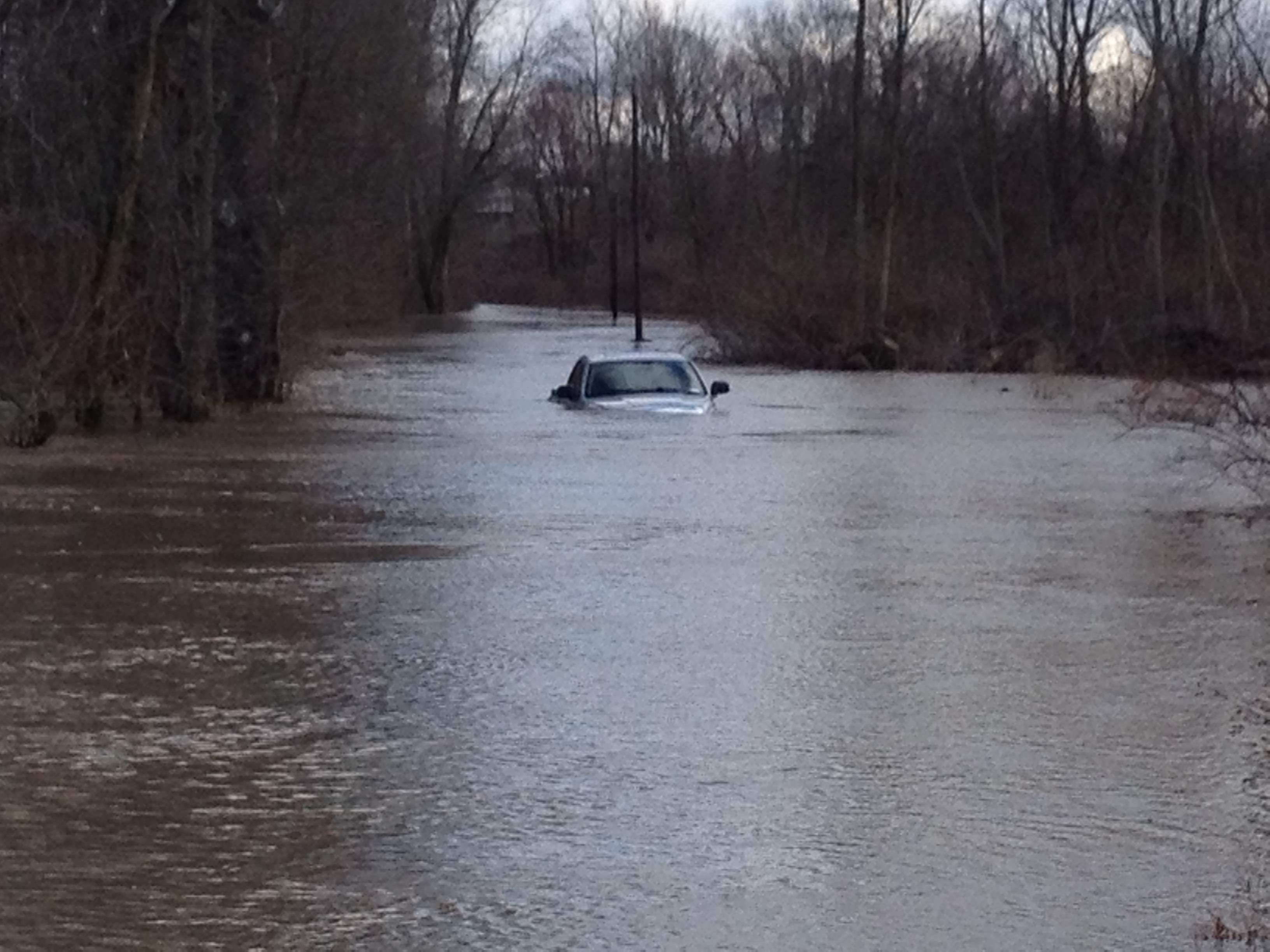

We have had plenty of rain in OH past few days too. Just took this pic with phone, river down the road. They had to send river rescue after the passengers about midnight last night.

Either that p/u driver didn't know the road, or confused their truck with a boat !
