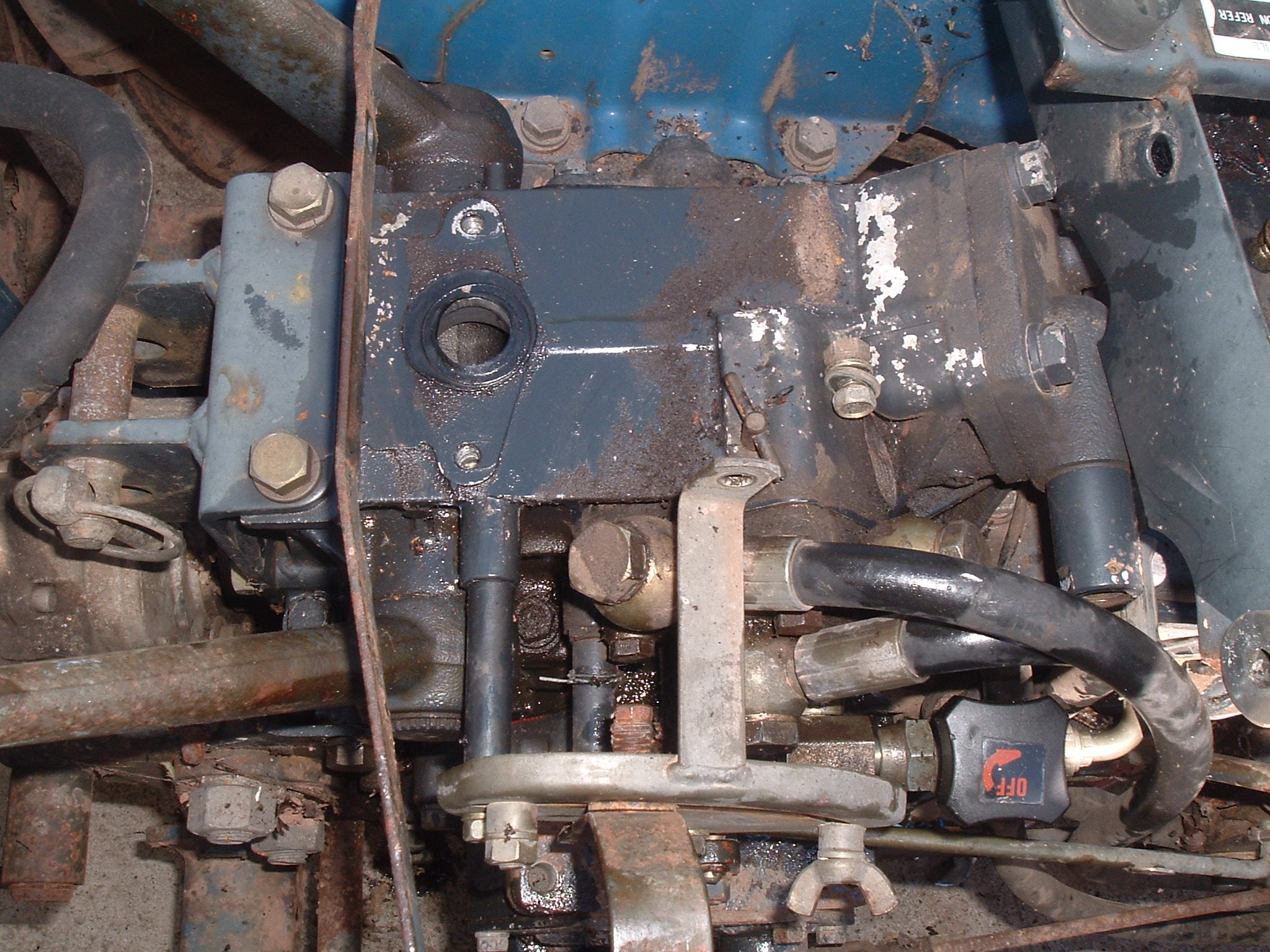

Below is a photo I took some time a go. I've taken 'D' out which is a prv, however now that I've got a manual (very basic on hydraulic info) it appears this may be a safety valve at the end of the hydraulic cylinder for the 3 pt linkage. 'A' controls the rate at which the 3 pt linkage raises and lowers.
'B' and 'C' are the flow and return pipe to the fel. Theses are plumbed to a manifold block. Are you saying there may be prv's under this block cover?
The unmarked arrow is to a shut off valve that feeds a quick release coupling on the wing.

Does your manual have a specifications page?
From the pictures, you have found both relief valves.
Can you provide flow path for your hyd?
The first relief valve in line will be the master relief, and the other relief can be set the same or lower.
Did the 3pt indicate the same pressure as the FEL.
Where was the gage when you did the 3pt pressure test?
The loader should be at the end of stroke, because the load will dictate the pressure. If you are only lifting half the potential weight, then you will read less pressure. The cyl must be at the end of stroke for max psi testing.

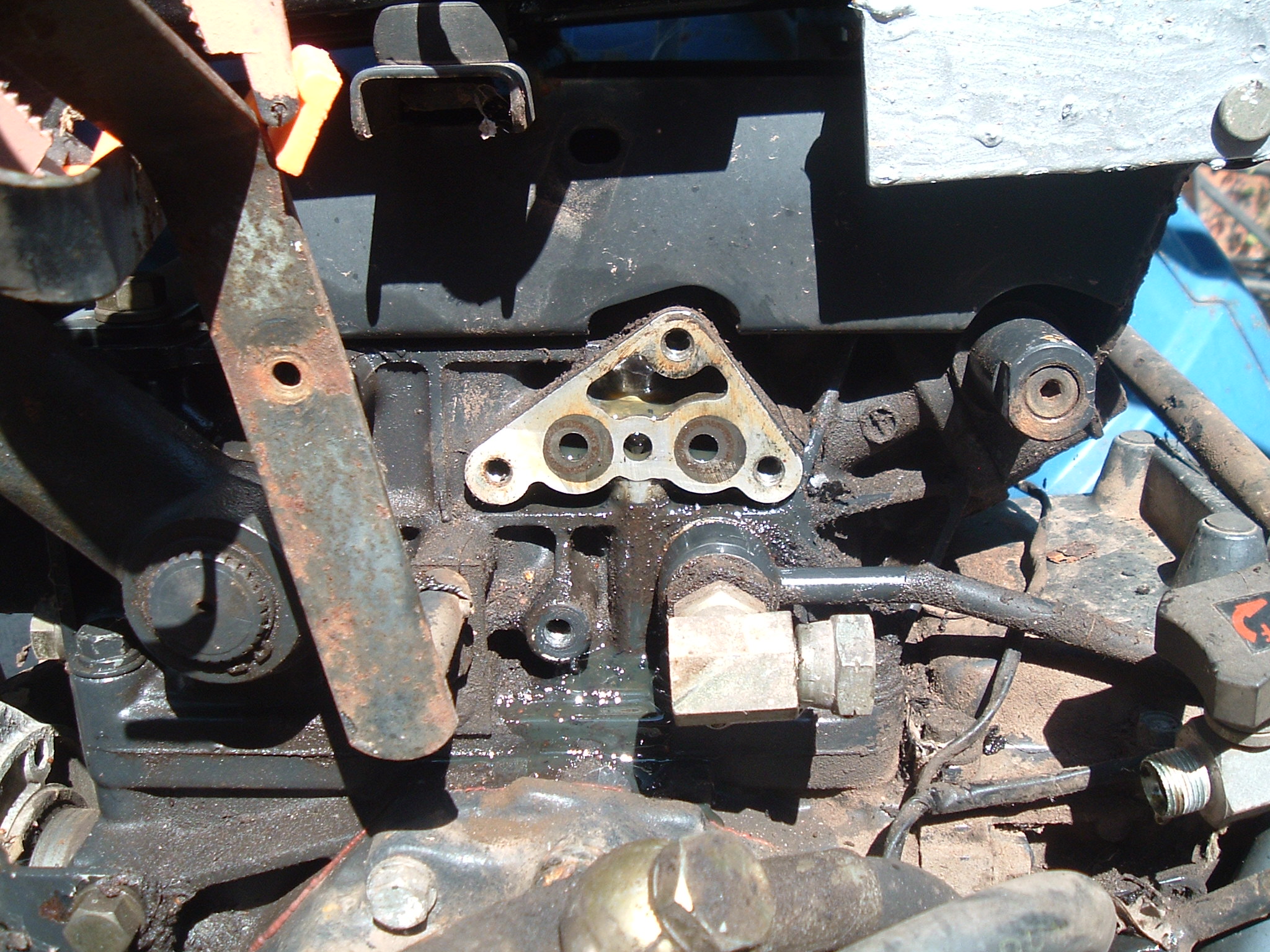

Well... I've stripped hydraulic manifold off the side of the gearbox as shown in the photo below
Well the block is just a manifold, nothing more. looking down the holes on the side of the gearbox, there are no screws, all you can see is a port drilled off to the side and the bottom of a drilled hole. I even removed the bolt holding the pressure line from the pump to see if there was any screw within the threaded hole. nothing...
In another vain attempt to find a hidden adjustment screw or what ever, I took the pressed steel seat bracket off the top of the gearbox, but nothing.
Well I'm stuck again....
