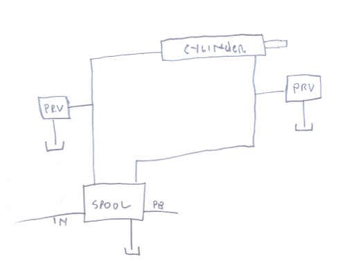

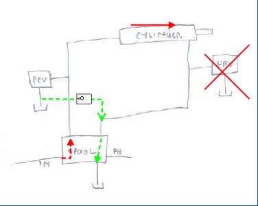

<font color="blue"> Your earlier example of a PRV in parallel with the cylinder will not work unless I misunderstand you definition of parallel. </font>
I'll try to be less wordy this time... /forums/images/graemlins/grin.gif
Easy to say, hard to prove. Explain why your statement is true. I doubt you can.
Jinman's modification of your drawing (what you show in your drawing will certainly work and is traditional design) is exactly what I suggested as an alternative thought.
Rather than just say something will not work, please add a few words to explain why it will not work. Doing so is all around helpful for whoever may come upon this thread in the future. /forums/images/graemlins/smile.gif
Edit: I guess you posted a reply while I was typing this one...

WoW!!! Thanks for all the responses . This is why I love this site .
OK , I will admit that I am "hydraulic challedged" and need to learm much more . /forums/images/graemlins/crazy.gif I called and talked with a "tech person" at the Surplus Center this morning . He told me a "pressure relief valve" would work just fine as long as I had a return line in the system . This is what he sold me : http://www.surpluscenter.com/item.asp?UID=2004120115123318&catname=hydraulic&qty=1&item=9-1034 . The part I like about being able to adjust my pressure is the ability to multi task my remote hyd. valve .
I know I could have got a smaller ram in place of the existing one ,but it might have been difficult to get it right the first time and not ended up with one that was to weak . Besides it would be hard to find a ram for $42 dollars,which is the valve cost , and I can keep adjusting to where I want my psi to be . I will keep you all informed as to how well it works .

Not sure if poster has 3 spool valve or seperate valve for grapple. If it's a 3 spool, all circuits are tied to one relief. For that the afore mentioned smaller dia cyl is simplest and cheapest. Personally, I'd rather run power beyond and seperate valve with adjustable relief for the versatility (shearer).
You have to have power beyond sleeve on most loader valve returns or use a flow divider upstream of loader valve to grapple control. Open center systems can't be tee'd on press side unless you're willing to dog a downstream control handle off so all the flow doesn't pass through it. Wouldn't work so good for loader application.
