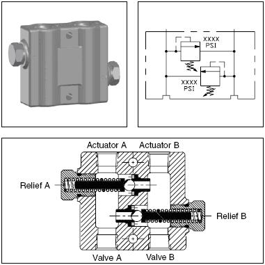

Got a diagram for the hookup of that valve? Please guys keep it simple.
   / Pressure relief valve #15
Normally a cross over relief is mounted as close to the cylinder as practical. But since you are not interested shock load reduction, you could probably mount this valve on the back of your tractor close to your auxiliary connections. This type of valve is basically inserted in series with the lines from the valve to the cylinder. Refer to the first attached image. The two lines from your tractor auxiliary ports go to the Valve A and Valve B ports and the Actuator A & B ports go to the cylinder. Before ordering a valve, you need to decide the pressure and port size you want. Valves are available in different pressure ranges.
The valve here may suit your application as it is adjustable from 1500-3000 psi.
Crossover Reliefs (Cushion Valves) - Cylinder Services
Another option is to mount a relief valve in the line that closes the grapple like AKKAMAAN proposed. With a valve like the Parker Series WJL shown in the second attached image you may be able to support with just a quick disconnect plugged into your auxiliary connection. One P port goes to the tractor auxiliary quick disconnect and the other P port goes the side of cylinder that closes the grapple. However, you will have to find a tank connection on your tractor for the T port.
The relief valve is cheaper than the cross over:
Differential Poppet Reliefs - Cylinder Services
