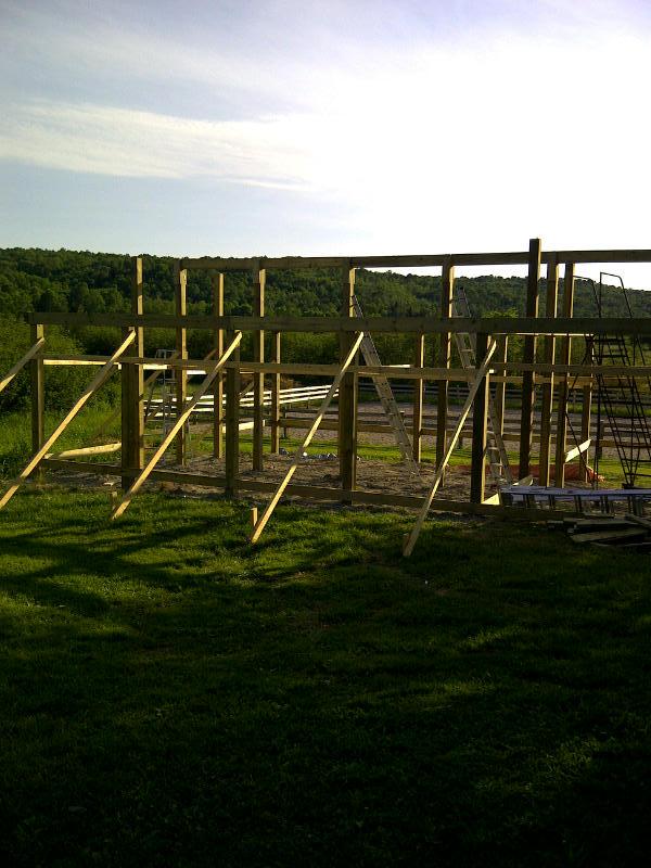

I started to build a large kennel using the pole method of construction. This summer I planted 30 6X6 pressure treated posts. I then had to leave the project due to work. Now that i am back to working on the kennel, over half of the posts have warped bad. I've been doing a lot of research and found out a lot, that i wished i knew before i started. I would like to use 3-2X6's laminated on top of the 6X6's but the dimensions don't work out. Also a recommended way of splicing. Any thoughts???

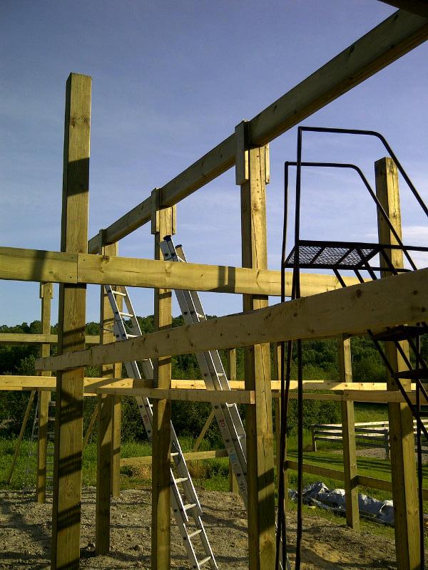

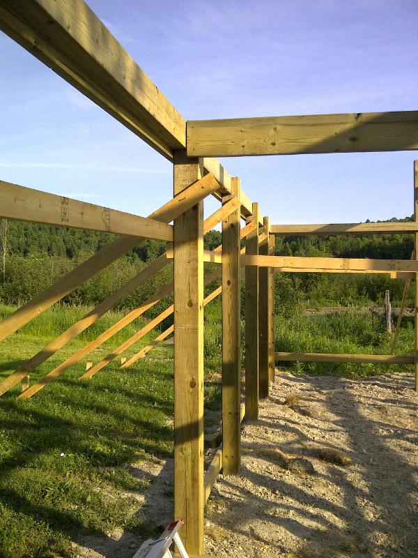

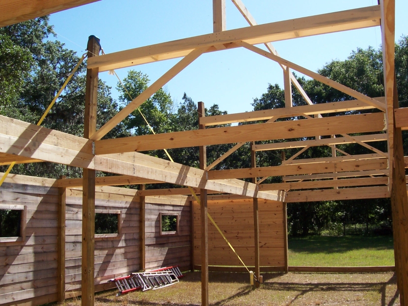

Maybe one of these methods will work for you, i used the same 6x6 posts, and my main beam is 3 2x8's on top (1st pic)...you'll have to use a couple of pcs of ply to get the full with of the 6x6 though.
Side beams are done a bit differently, notched the 6x6

Here is probably what happened:
The twist failure could have been prevented back at your post selection phase. If you can help it, never buy a piece of lumber or timber, treated or otherwise with a "bull's eye" on or near the center of the plank or post. This indicates the center of the tree rings which is by far the most reactive area to twist during the drying process. The further away the piece is from the center of the tree, the more docile it will be-do however try to avoid wain on the outermost cuts so the edges will be sharp and square.
As far as round posts, avoid them at all costs unless they are fully air dried so most all of the twisting factors are null by then. A round post is nothing more than a "peeler core", the bi-product from a plywood mill, the leftover core of the tree from spinning off the log's veneers and are mostly straight up bull's eye sticks.
If you order timber stock from a lumberyard to be delivered to your jobsite and you want to avoid bull's eye pieces, spec "FOHC" free of heart center but be prepaird to pay a little extra for the service.

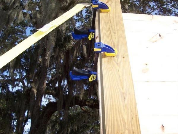

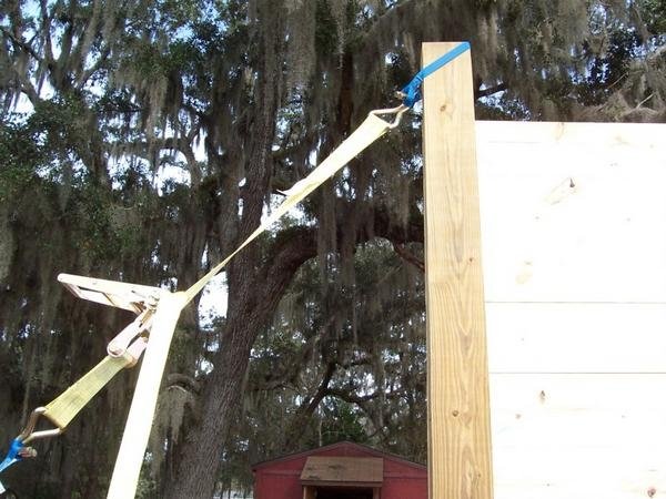

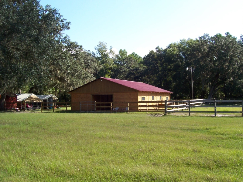

I am with you... I started work on my pole barn and it took over 6 month to get it done, my post were a mess and to make matters worse, they were 4x6 post. What I ended up doing was using tie down straps, placed here, there and where ever else to make the poles true again, while strapped is when I added my 2x8s to keep everything true. It worked, thank God, because I thought I had a bigger mess that I wouldn't be able to fix. I'll post a few photos for the heck of it.

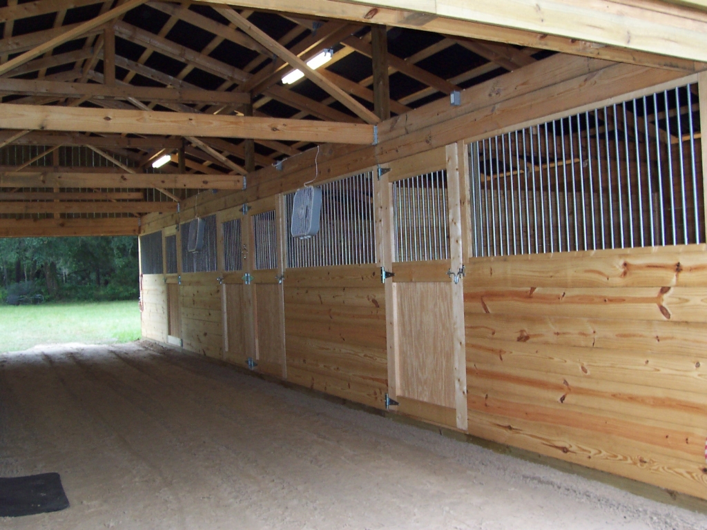

And a photo of the inside...
