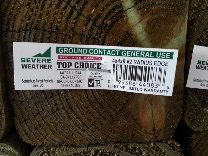

Running some errands today I stopped into the local big box store and was curious-the following are pictures of the tags on a 4x4, 4x6, and 6x6 I found there:
Notice that all are rated "UC4A", the lowest rating for ground contact. In the AWPA document I posted above, UC4A is recommended for fence posts, deck posts, and utility poles in regions of low decay potential. The next highest rating, UC4B, lists "permanent wood foundations" and "building poles" in "regions of high potential for decay" as applications. Food for thought...
I know this thread is old, but I came across it while trying to figure out if there was a better treated wood pole these days for sinking into the ground. The 2nd picture here is definitely the better wood because it is .40 ACQ type UC4A which would even be better than CA-C .31 UC4B. My question.....is ACQ treated lumber still available?? I'm a little reluctant to use the UC4A "ground contact" poles from the big box stores to sink into the ground to hold up a structure. They are only .15 PCF Ca-C treated. If CA-C treated lumber is the only thing available these days, I would rather use UC4B @ .31 PCF.
