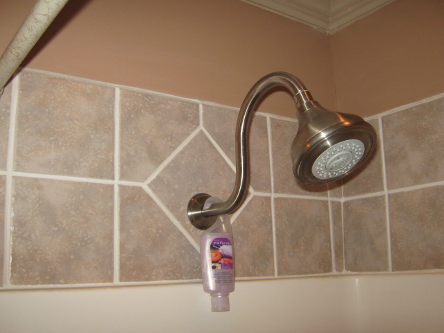

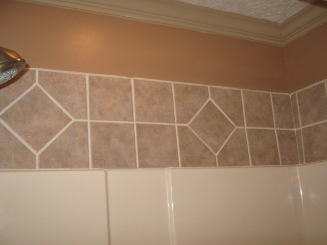

I think you should tear out the sheetrock that surrounds the tub inclosure mix spray of bleach/clorox and sray everthing down let it dry , and install either durarock or green board, then tile the above part of the shower/tub and use tile grout sealer you'll be good to go, I can see everyone now looking out their bathroom window,, :D
View attachment 287999View attachment 288000
I think this is a good approach to the problem. I went ahead and put tile in our shower area above the side walls and it has been over three years with mode free bathroom. I did the clean up and removed the mode before adding the tile. I agree with the green board too, although tyhat is a bit more work to get the project completed.
