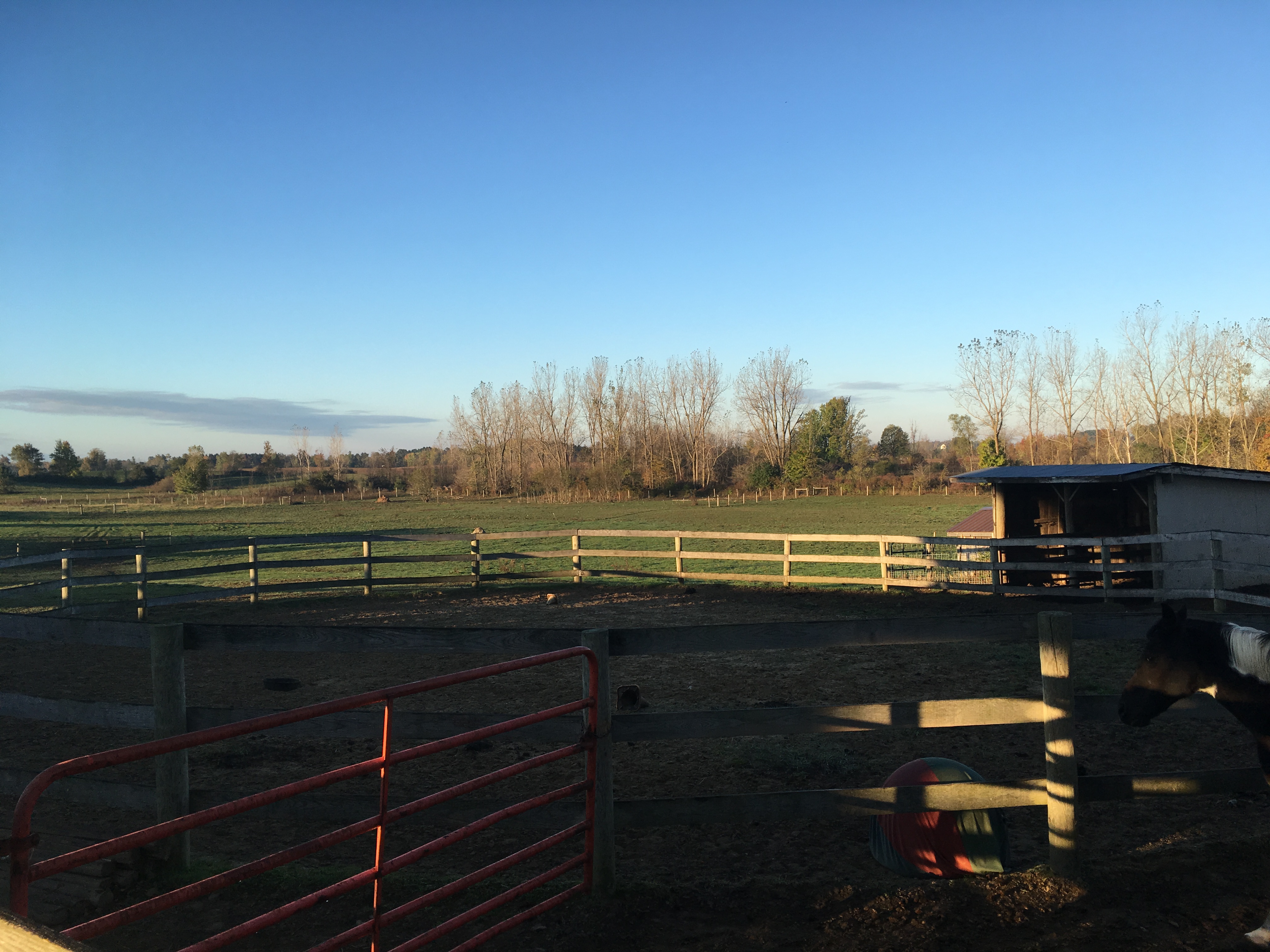

I never set posts in concrete. I auger out the hole then clean out the excess with a hand post hole digger. Set the post in and tamp the dirt in with a steel tamper (this is just a piece of 3/4' round stock 5' long with a 2"round 1/2" thick steel cookie welded to one end) until the dirt is packed in good and the post is firm. Here (Michigan) we put posts in 42" deep so that the frost doesn't heave them up. OOsik is right about the railroad ties but if you're using it for an arena you probably dont want your horse - or you touching sticky creosote. Attached is a picture of our 60' round pen. It is ten years old. 006.JPG006.JPG
