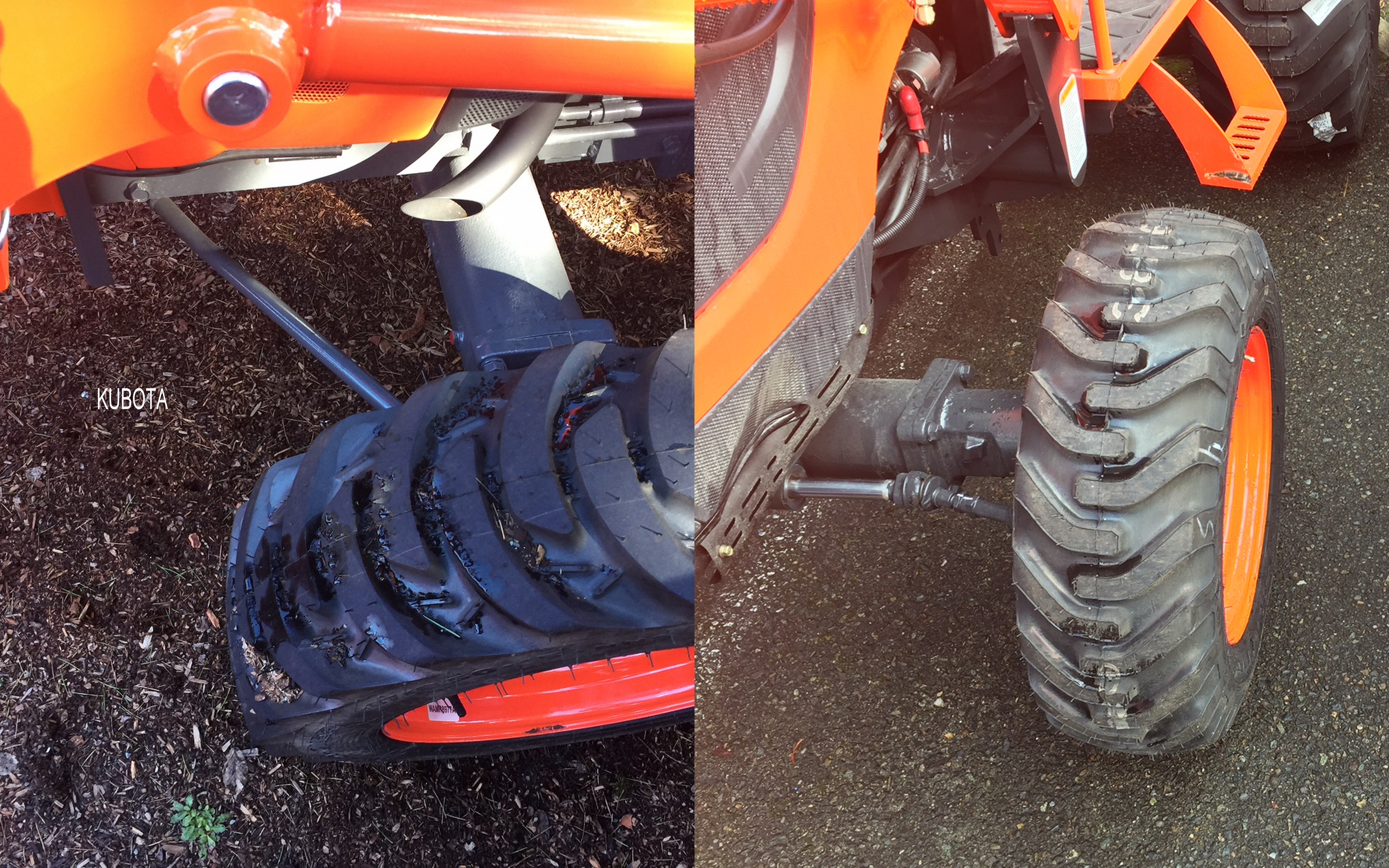

CK2610 vs L2501
Every other tractor in this size range is using full hydro-static steering - except the Lxx01's. Definitely not in this century!
- The hump gets in the way - the steel deck will be deadly with snow. Some "mat" solution or anti-skid would be required.
- linked pedal function is not available from Kubota.
- Both the CK2610 and L2501 have crap 3-point hardware .
- Kubota dealer is further away, and on the wrong side of a town that has a traffic bottleneck problem. That fact likely adds 1 over an hour to a trip to get parts.
- Fuel tank location - the TC25 has the tank in the same position as Kubota - it's a pain with fuel jugs, and difficult to not spill on the hood.

I had seen a sales comparison favoring the steering on the Kioti over the Kubota. But what I wondered was how susceptible the Kioti's actuation cylinder would be plunging into brush, etc.- see attached. I wondered about nicks in the sealing surface being a negative. One dealer simply said 'Never had one come back for that', which I take with a grain of salt.
