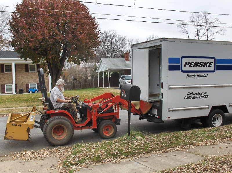

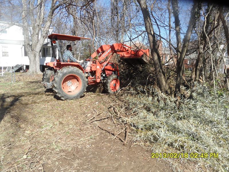

Size is relative to what you NEED to do. Tractors are rated two ways for power, Engine HP and PTO HP. My first tractor, the B7610
attachment.php
I'd call a small tractor, for what you wrote you need to do. The B7610, 23 HP/18 PTO HP, will barely pull a 14" 1 bottom plow. FEL lift capacity is 352 kg or about 700 lbs. One of the reasons I bought it was for maintaining trails in the woods, where a big tractor will be a pain.
A few months ago I was in earnest search for a tractor of about 40 HP that would handle a 10' log (about 2,000 lbs) on the 3pt and cost < $15K. After scouring Craigslist, tractorhouse, dealers, etc. I ended up getting my M4700 for about $12K at a local county auction.
attachment.php
More power than I needed, 50HP/42HP PTO, but I'll cope with it. It'll handle 2,000 lbs on the FEL and 4,000 lbs on the 3 pt. I'll call that a medium tractor.
