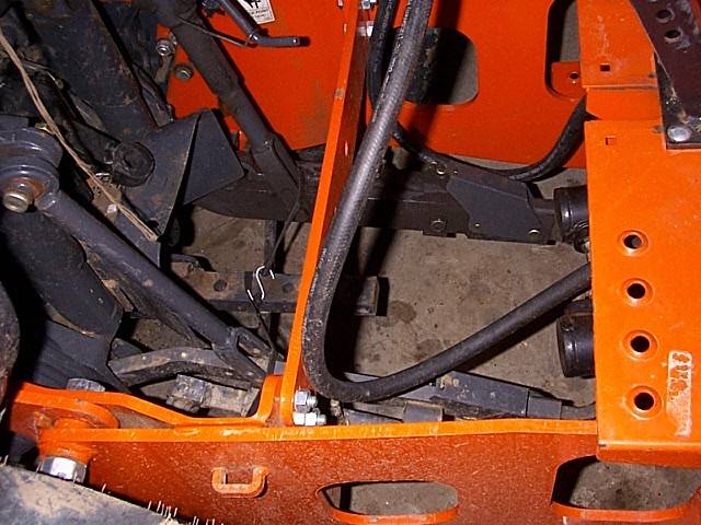

Forgot to take pics last night, got busy soldering pipes and stuff. I snapped a couple pics ina hurry this morning and just got them edited down to size.
In this pic you can see one of the left bolt that connects the hoe to the subframe. You can also see the 3pt and swing arms strapped together.

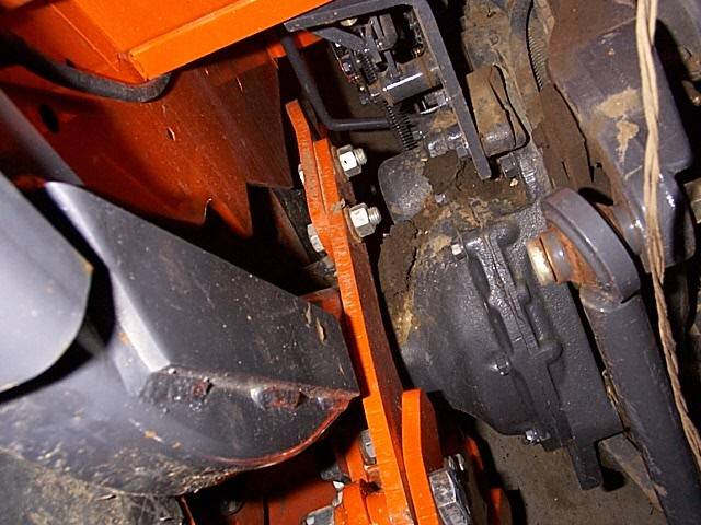

Another shot of the bolt connecting the hoe to the subframe.

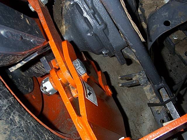

Here you can see where top half of where the two subframes bolt together. This actually goes all the way around and bolts on the bottom as well.

CT, thanks for the pics. It looks like the Woods mounts simular to the BH90. It also looks like it uses the factory loader subframe, just like the BH90, it just sits a little further back so you can leave the 3PH arms attached.
Im already commited to the BL4690B at this point but if Im not happy with it, I will definately look hard at the Woods setup. At this point, Im glad to be staying with a Kubota product and for my needs, the BL4690B is better suited than the BH90.
