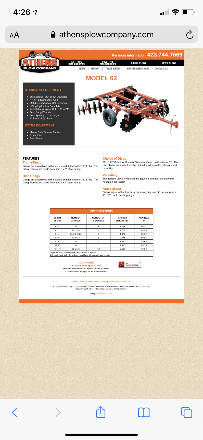

For that weight you must be looking at an Athens offset disc with 22” or 24” blades. The only way to pull it with your tractor is raised. They are rated for 90 hp tractor or larger.

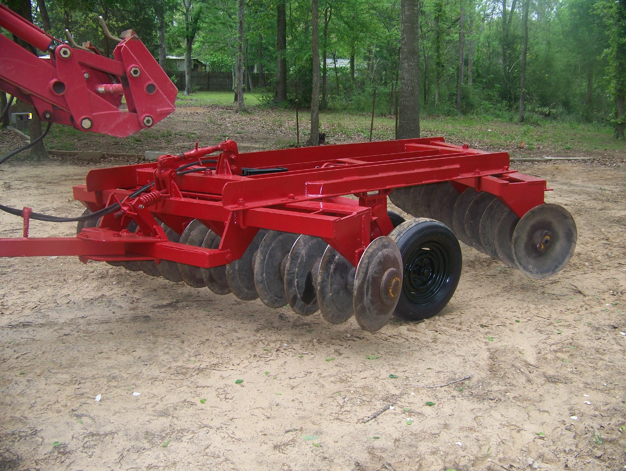

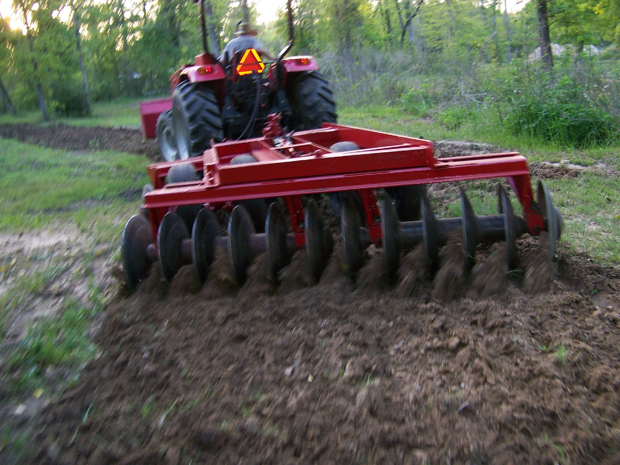

I had a Amco 9 foot offset disc. My Mahindra 6520, 4WD, would pull it okay, but I couldn't run it in the gear I needed to make the speed I needed to turn the sod completely over in hay pastures. I had the weight, but needed a few more horses.
But on my place, one pass and it was ready to plant a garden. You can see the dirt being thrown over here........
She was over 3,000 pounds.
What is the drawbar horsepower of your tractor? I think it will be iffy, but doable.
hugs, Brandi

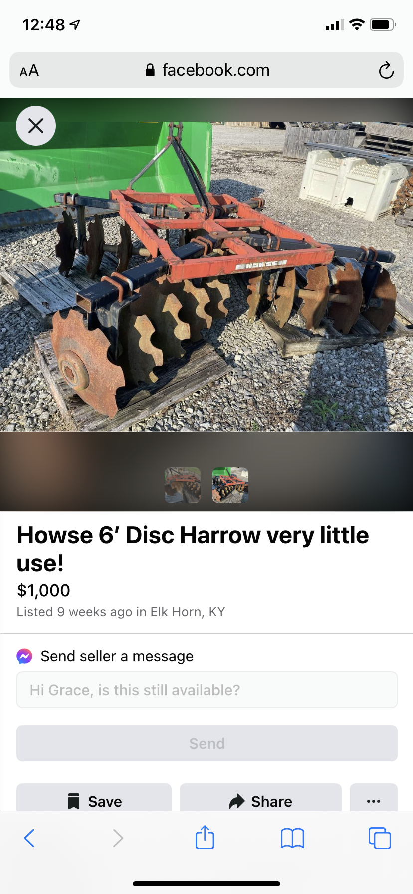

Found this about 2 and a half hours from me. They said it’s still available but haven’t answered any of my questions on weight/pan size and spacing of the disc. Maybe they only made so many types in this 6’ size that could narrow it down? Looks heavy.
