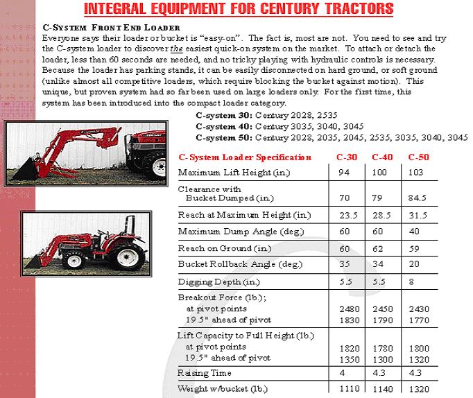

Century Loader Chart

All other factors being equal, the C-50 is the way to go. The mounting is much stronger than the C-40, not that those are weak. The bucket and loader also come off easier. By all things being equal , I mean if you're loosing the rebate and there's the $900 difference plus the cost difference between the two, I would evaluate it. You don't say how much the TC40 is or any details on the JD so it's hard to advise on that aspect.

Hey John,
Any ideas as to why the specs overall for the C40 look better than the C50? Yes the C50 is a bit heavier and a bit more height,but for working angles the C40 is superior it looks like. Is the C40 4-bar linkage and the C50 not? If so that would explain the differences in angles acheived.

It appears the C-50 is going to be used across the entire line and has been designed for that... ( one loader to stock vs multiple for the dealer)

I am not positive but I believe the C-30 and C-40 are the same except for the subframe and on the C-50 you need to order it with the right sub frame for the tractor. There is one for the large wheel base an another for the shorter wheel base.
