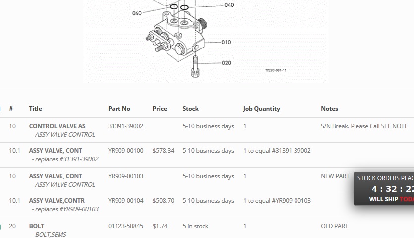

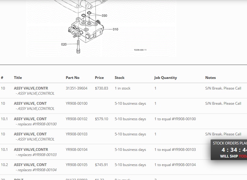

So in the parts diagram; L2800 has Old Style and New Style - Old ones are YR909- New ones are YR908- Most likely the replacement for the early ones is YR909-00104. Which would be the semi-smooth/jerky one**.
**After the super jerky hitch, from mid-2006- for a while... people still complained about a "jerky" hitch but they were nothing compared to the original valve. It's a rumor that at some point kubota "said" they made internal changes that would not allow Grand L valves to be inserted into the "Standard" L tractors. I have my doubts...
