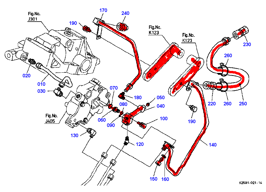

As I am a newbie to the world of hydraulics, I am trying to understand what I need to do to add rear ports so that I can eventually hook up a Woods BH6000 to my BX1500. I have talked in great detailed with my Kubota dealer, the dealer at tractorsmart.com, as well as a technician at Woods.
Woods informed me that all I needed was a set of rear ports, but didn’t. My dealer wasn’t too sure what I needed. The dealer at tractorsmart.com said I could add the rear hook up that is the same as the BX23. With that, the “factory” modification does not require a three hose hook up to the BH. See attached. I outline in red the route of the modification.
After gathering this information, I went to my local deal and check out the plumbing on a BX23 and sure enough it was the same as what is illustrated in the attached. These two ports are what the BH connects to when attached. Also, and I believe this is the key, is that when the BH is not connected, the rear ports need to be connected to each other to complete the hydraulic loop. As you can see, I have to replace the block that the FEL is currently connected to. All of the factory parts cost me about $250.
I haven’t hooked it up yet, but plan to in the next few weeks. I am assuming, from the info gathered on this thread, that I “could” connect other implements that contain their own respective valve(s) to the rear ports (i.e. log splitter, PHD, etc.), but would not be able to correctly operate the 3PH at the same time as the respective implement? Any clarification would help.

That is correct.

Just finished installing the rear remote hook up on my BX1500 today. This is the same exact way the BX23 is set up. Cost me about $250 from tractorsmart.com. The person I dealt with (Ronnie) was extremely helpful and even sent me outlined parts diagrams to assist in the hookup.

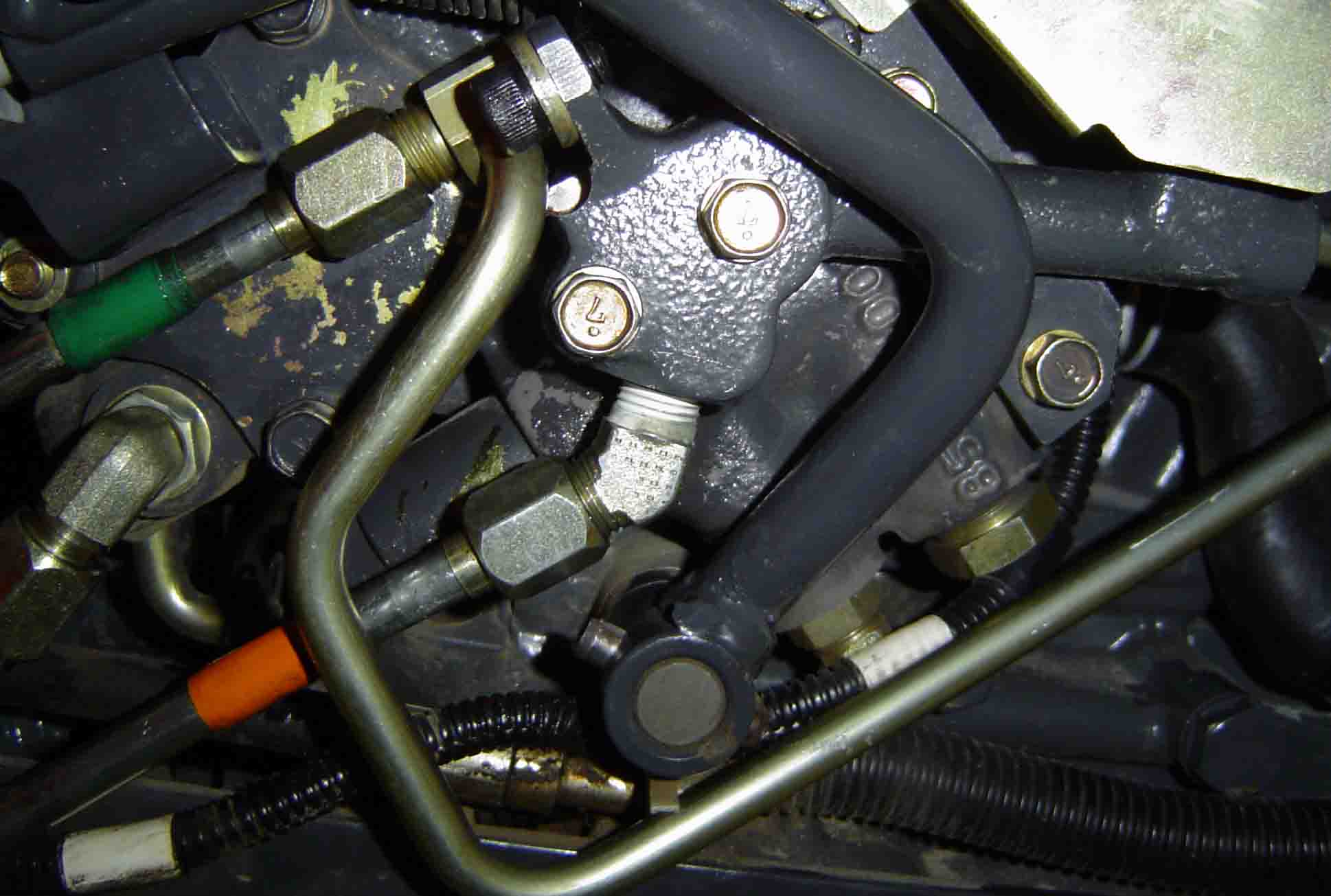

Here a pic of the hydraulic "block" that replaces the one that is installed with the FEL on the BX1500, BX18xx, and the BX22XX.

Another pic.

One last pic.
The reason I added the rear remotes was because I am planning on installing a BH. As was said earlier in this thread, I will be able to use the rear remotes for additional control valves, but in this set up, the 3PH valve will not operate simultaneously with what ever is connected to the rear remotes (as MAD pointed out).

By simultaneously, do you mean that you can't operate the 3PH while you have something (anything) connected to the remotes, or just that you can't operate something off the remotes and raise/lower the 3PH at exactly the same time. The first sounds reasonable, the second doesn't sound right to me (but I could be quite wrong).
Did you get all this working, btw?
